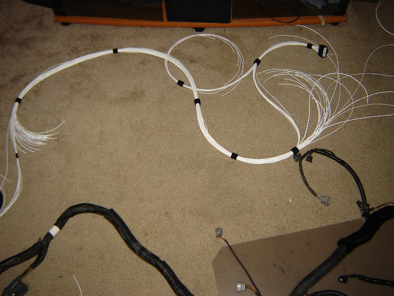

    I'm working with Yazaki, I'm hoping to be able to make the terminals readily available. Dr. Tweak at Phoenix tuning has them for $1.00 a piece, but he didn't respond to my phone calls once I was ready to order. Odd...
    Here is my latest order:
    Link to the web album.
