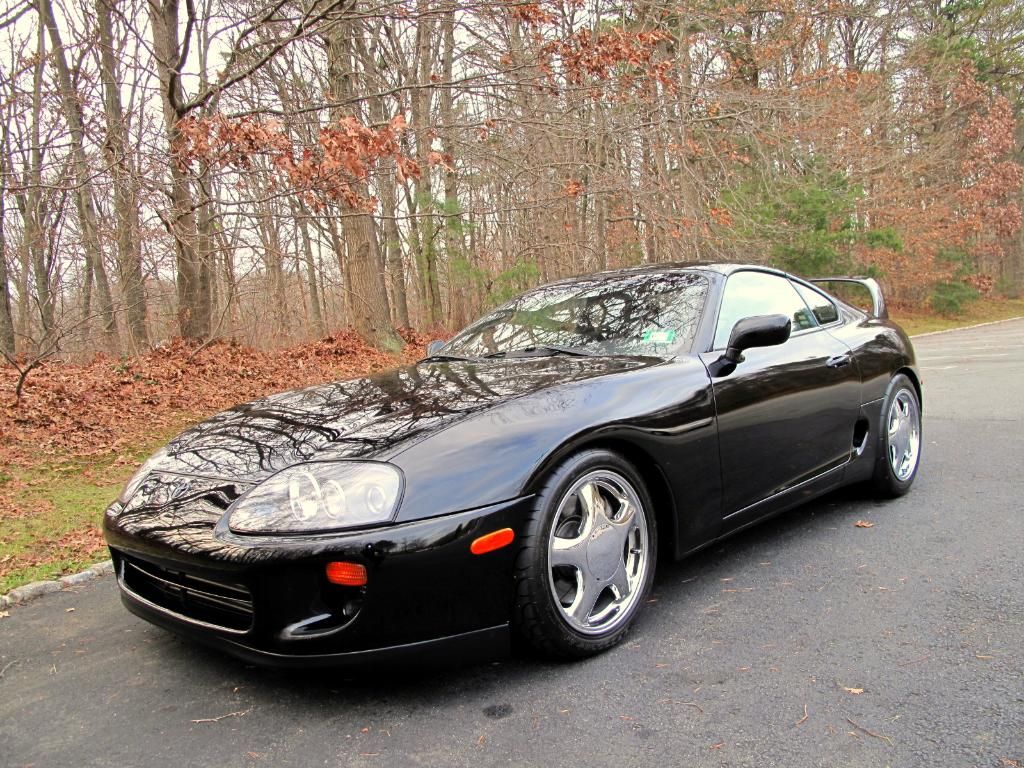

Just as of a couple months ago I purchased a 997 Porsche Turbo, So I have been contemplating selling the Supra. I've had it for alittle over 5 years now. Quickly after purchasing the Supra I swapped out the Factory ECU with an AEM, Built a 3" Exhaust and installed a EBC. Iveytune Tuned the car to 457HP/487Tq Pump gas. Best I had on the Twins was a 11.2 on MT Drags pump gas. I figured before I sell it, I ought to put a single on it, since afterall I never drove in a Single one. I had a Local shop install a set of HKS 272's and Build a kit for me with a Precision Billet 67mm, Tial 44mm Wastegate, 3-4" Downpipe and a 4" Exhaust with (2) Mufflers. The car is totally transformed. Alot of fun to drive on the single, The 315's would barely let loose in 1st with the twins, now the car will get loose in 3rd at 17psi. I immediately hit the track up.
Only got 2 pass's in. 1st pass I didnt get enough heat in the tire and spun bad had a 2.3 60ft and went 11.8 @125 on 18psi. 2nd Pass launched at 17psi and then switched it to 28psi in 2nd gear. Went 10.6 with a 1.58 60ft. The track official then asked me to leave :( No Rollbar
Within the last couple years I have had the entire car stripped, Repainted, New weather stripping, all new moldings, front spoiler, side skirts, fender guards and Lights replaced. Inside Ive replaced the Carpet, Floor mats, Recaro Seats, Dash, Gauges, Gauges rings, DVD NAV, Steering wheel and Shift Knob to name a few.
Enjoy the Pics.

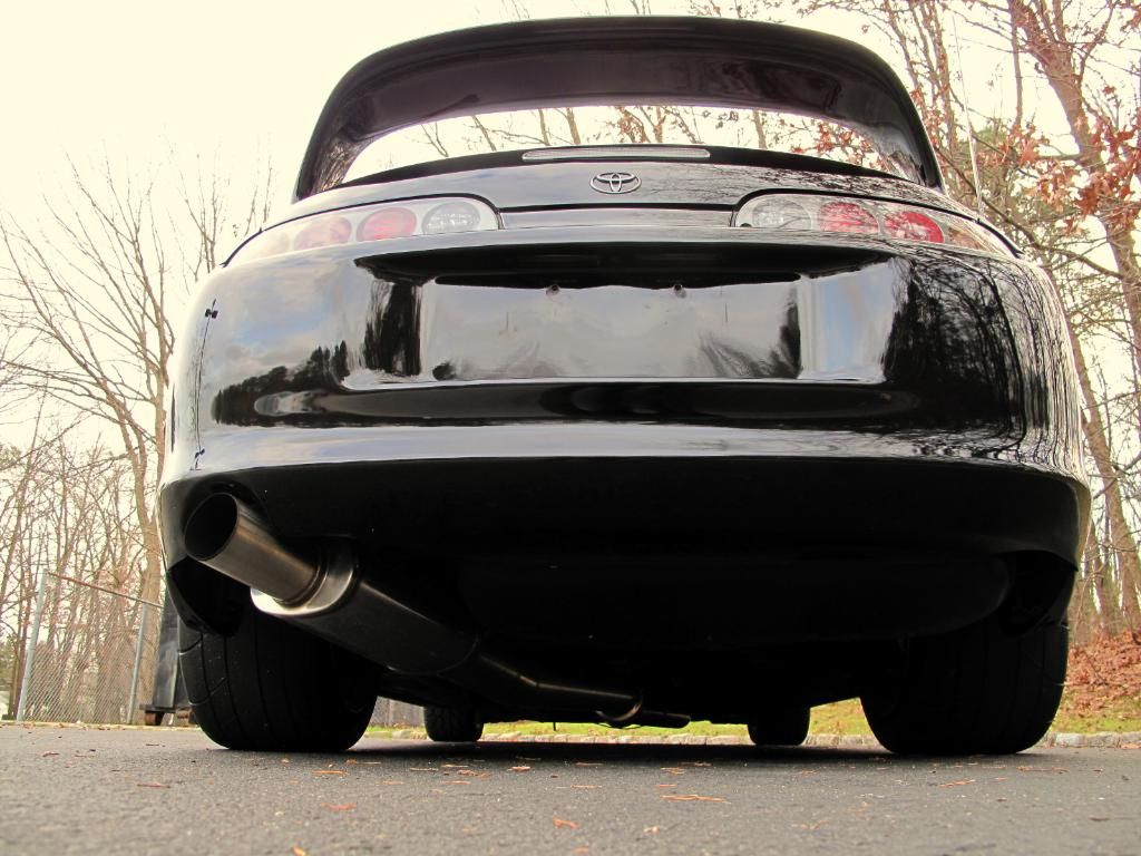

How about some details on your exhaust? I hate fartcans, and your exhaust is EXACTLY what I have in mind. I see the oval muffler out back and what looks like a canister muffler up front. Specs? Undercar pics?

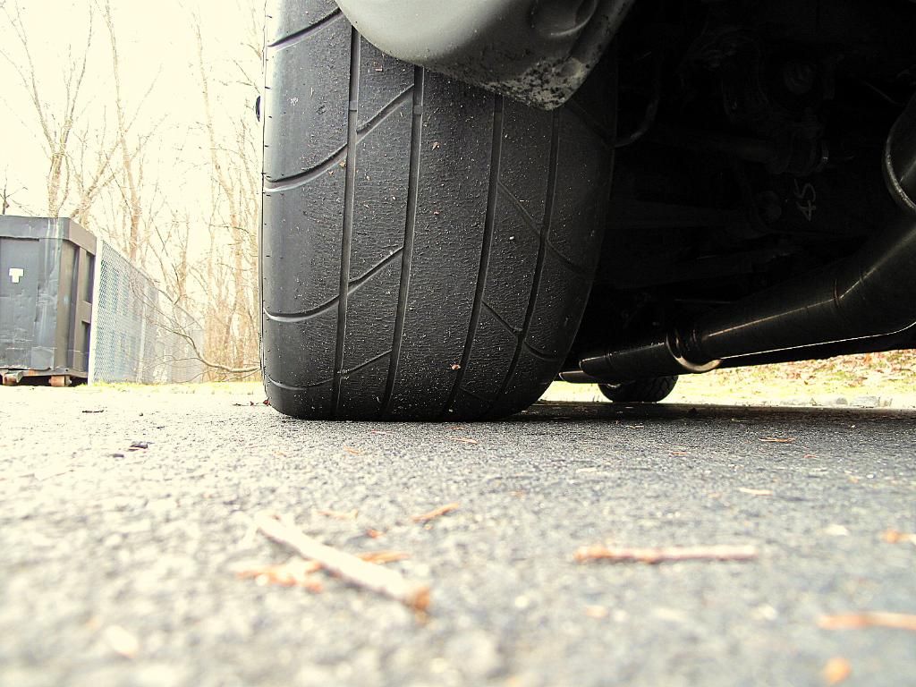

Some beefy tires!

FYRARMS... mannnn ive seen your posts for over 5 years, if there is one person who I thought would respect the Oval Can It would be YOU! TNP the car does have 2 Magnaflow mufflers, 1 bullet 1 Oval as you described. I had a Borla XR1 Oval with the 3" before. While I do not prefer the N1 Canister muffers at all, they do seem to flow with the Supra Better than any car. I do have some undercar pics Ill dig up.
