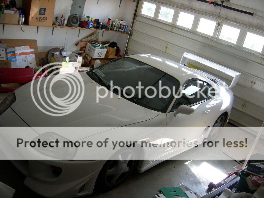

The car wasnt really taken care of by the previous owners. Not trying to badmouth them, but I suspected the car to be sitting outside for quite a bit since I noticed the paint fading on the roof. That lead me to realize soon, that the car was just sprayed over when they installed the Blitz bodykit. Knowing it'll be some responsiblity on my hands, I still have absolutely nothing to complain about. But soon I started the teardown of the body around march..

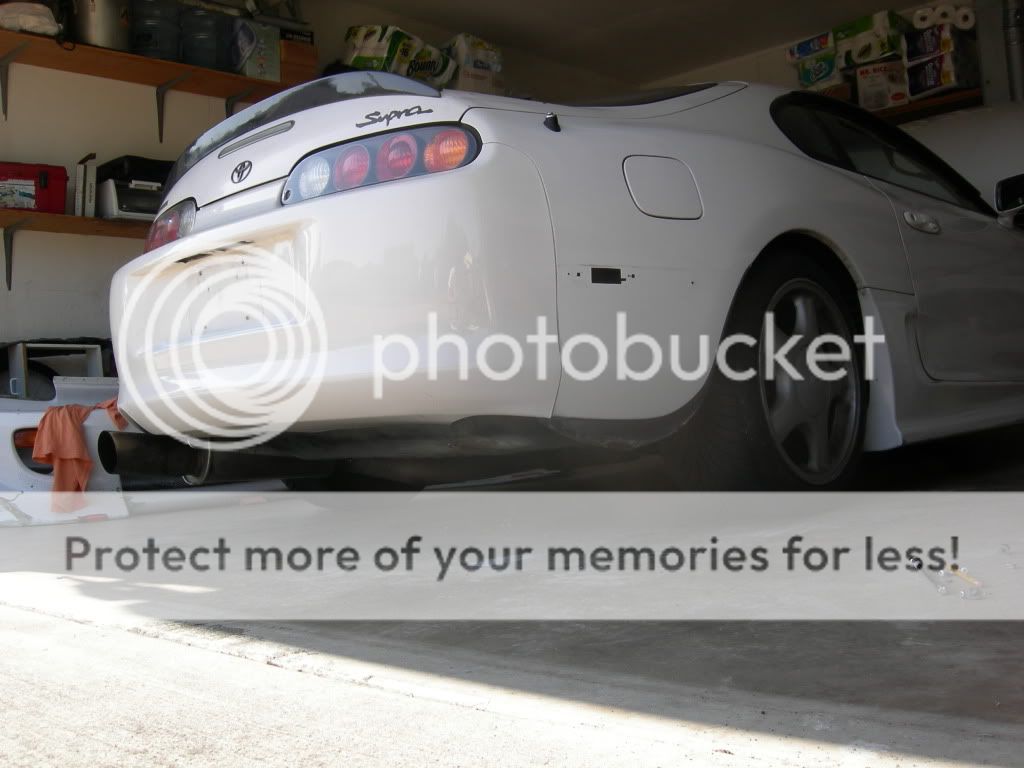

Heres the rear end after the bodykits off besides the side skirts. I'm glad that the bodykits taken care of. Since the whole bodykit was riveted on, what would you guys suggest doing about those rivet holes other than bondo? I'll grab more pics of the rear end once the stock wings on w/ the lip along with the side markers. But for now, I'll temporarily leave it wingless..

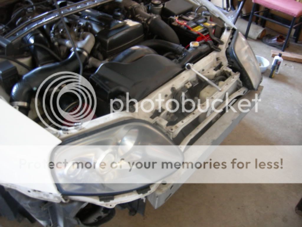

Heres the result after I de lined my headlights not too long ago... Being my 1st time taking a shot at it, it took me about a month and a half. I spent a majority of the time during school to get them done. It didnt turn out too bad, but could be better. Its not exactly something I'd enjoy doing again, but Im glad its over with for now..

dude, don't just slap bondo over those holes. you gotta weld those holes shut. then grind the welds down. then u can lay bondo over them. if u just fill them in with bondo the bondo will crack and "shrink" showing the holes. believe me i do body work 4 a living.
#6 ·
Ohh, Im wasnt talking about putting bondos over the holes, I was asking if theres any way to fix them without it. I was actually wondering if they can be welded up instead, would I still need bondo? The blitz side skirts are full of rivets, so I left it alone for now... I'm planning on getting Ridox side skirts in the long run, would I have to rivet those on too?

#15 ·
nah, u gotta use bondo to finish the body work the car. but, the trick is to use as little as possible. u should only need a finger nail amount of bondo per hole if u do yur metal work correctly. n use a rubber sanding block when u sand the bondo. just to make sure yur body work is perfectly straight
