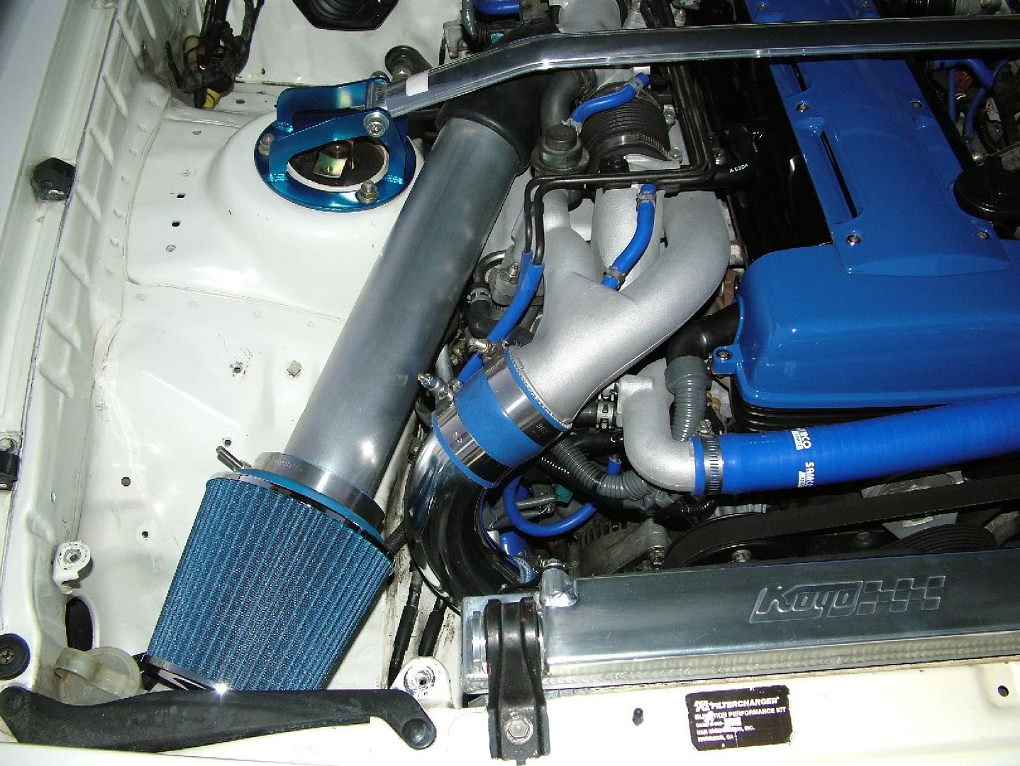

Jose and I did this project for a customer and we are very happy with how it turned out. I figured I would post it here for you to check out.
Here's the engine bay 99% done:
First drive video after exhaust was installed:
www.driftmotion.com/MOV04022.MPG
Intercooler setup:
Various install pics:
Some highlights are:
Cold Air Conditioning!
Brand new US MK4 TT wiring harness adapted to MK3 (BTW, with no trouble codes) JDM ecu so no MAF needed.
All factory gauges are fully functional
Electric fans with thermostat switch
Koyo Race Radiator
Custom intercooler kit
Cusco strut tower bars f/r
ACT clutch
BIC motor mounts
External oil cooler
Spark valley cover smoothed and painted by PJ Bonifacio

It's a 5spd r154 with a 1j bellhousing. I know arron didn't want to deal with that headache

HAHAHA, now we did one we would charge more! :1poke: jk
It has a R154.
Would a 6speed be possible? Yes.
Would it cost a whole lot more. Yes.
Is it worth it for a bpu 2jz swap in a mk3? I don't think so.
If money is no object then lets do it!
R154 is plenty strong and that one extra gear costs you lot of money!
The car may be getting a set of coilovers very soon! We have sway bars to be installed already.
Thanks for all the props guys!!!

Can you tell me how you connected the downpipe? I'm having a bit of an issue, using the Aristo cast iron piece... the outlet seems very small and I got a US replacement thinking it would just bolt up to the existing exhaust manifold, etc...
Anyways, I have a 3" MKIV downpipe which will match up to a US TT exhaust, but the Aristo's isn't easy to deal with.... what'd you do?
