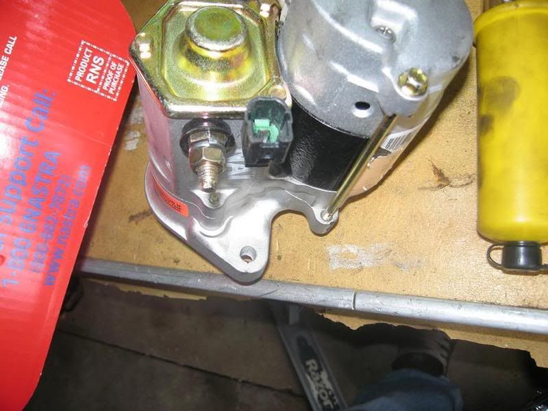

I am switching to a 2JZ starter on my 1JZ MKIII and all I need is a starter plug. I called a local Toyota dealer and they told me they don't sell that kinda stuff, so I figured it's worth a shot asking you guys. Here's what my starter looks like with the type of plug I need.

I am not able to see pics from my computer here at work. Can you look close and give me the number on the plug itself?

I called and talked to Jeff today and I think we found the part number, so I should be all set for now unless it's the wrong part

Part number seems to be 90980-11400, I'm going to order it and see if it's the correct part number!
The inner terminal would be 82998-12480
