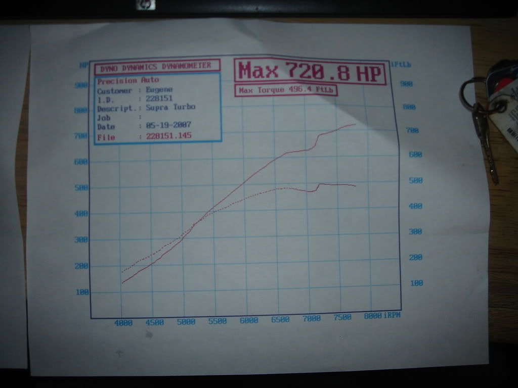

i finally figured out my problem where i couldnt rev it past 6k. turned out that the car simply wanted more timing!
once we got that figured out it was a matter of a few pulls to get the afr curve tuned in. the timing #'s are still pretty conservative and 720rwhp was only at ~26 psi. i wanted to go higher but my boost controller is probably POS that wont hold it.

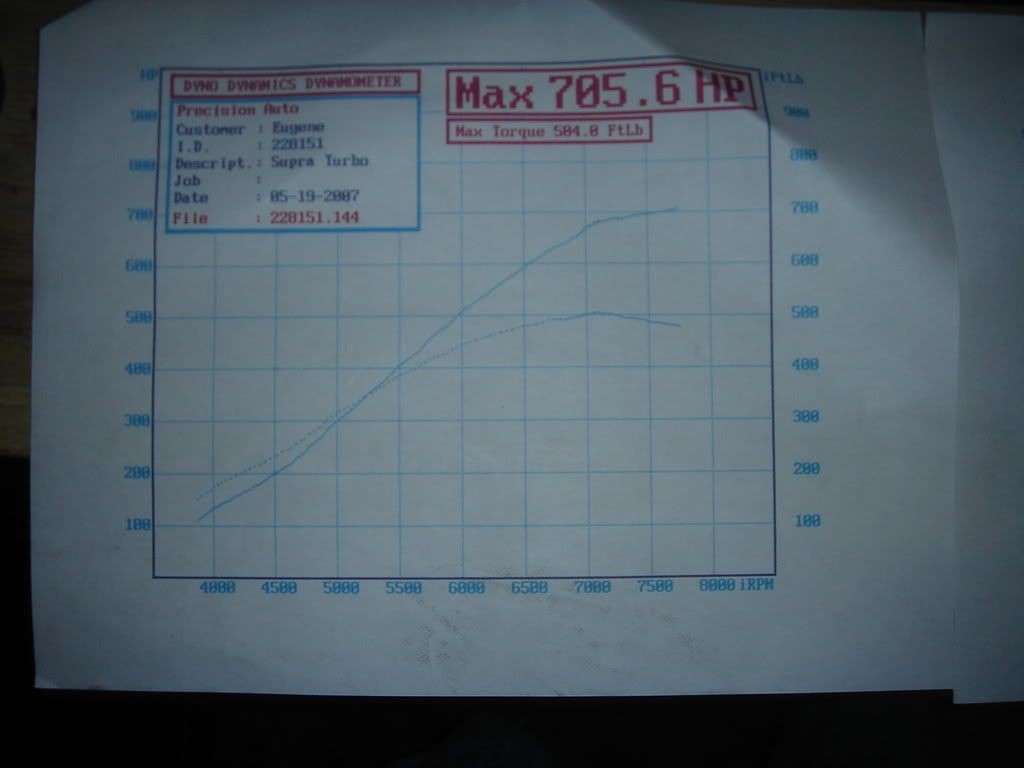

this run is where we tried turning up the boost, it spiked and then went down to ~25psi, hence the dip in power.
heres a cleaner run, held a pretty solid 26psi all the way on this pull.

Iv always been curious as to why most supras dyno such low torque #'s. To dyno 7xxrwhp and only get 500rwtq something don't seem right maybe your setup. Good #'s though im sure your happy. With the boost controller might sound odd but try a MBC. Last week went with 7th sign to dyno the gt47 and the EBC was acting up and giving some problems. The tuner and everyone else agreed the MBC is so much less troublesome and after swapping it out it was clear the MBC did its job well. It help 30psi no problems and the EBC was sold the next day. Hope you get all your little issues taken care of.

His setup is fine. Its hard to get accurate tq readings on an auto trans with a high stall.

wow with a 4000rpm stall if unlocked those are some awesome numbers at only 25-26psi. I think when i had my loose stall converter i only put down around 600rwhp at 26psi.

exactly, yes its an unlocked converter and these #'s are off a dyno dynamics machine which is known to read lower than dynojets.
