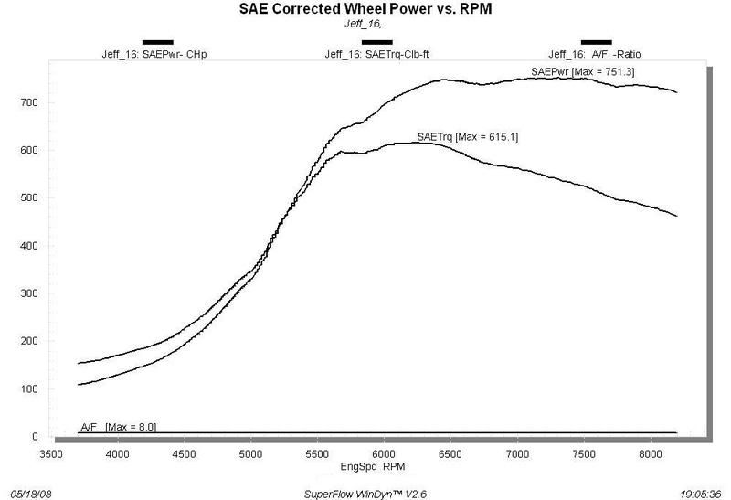

Hey guys thought I would share my numbers since I don't have anything else better to do right now. This was done with my 74GTS, E-85 and 25 psi. Feels good not to pay a butt load for C-16. And even a better feeling that I can get this fuel at the pump. My shortblock is still factory with a mild built head. My fuel system is still my virtual works kit with 1000cc injectors, dual walbro's and -6 lines. My plugs are 6097's gapped at 22. And I don't have to change them nearly as often as I used to.

Looks strong. How do SuperFlow numbers compare to Dynojet's?
#6 ·
Very nice,now run it at track to see what kind of traps you get thats alot of power for 25 lbs,I was only able to get 652 at 21.5-22lbs.

Ignition is just the HKS DLI with AEM. The injector duty cycle is maxed out with those injectors. The timing is super conservative. I am upgrading to 1600's to run 28 psi but the silver car Cody and I worked on made 673 rwhp on a 71mm turbo and 1000cc injectors on Sunday. But Cody ran -10 pro lite lines from the rail all the way to the tank and the car has fuel all day with 86 percent duty cycle. He loaded my map into the car and played with the timing and it made a huge difference. We believe there might be some 50 or more horsepower left in my setup if we play with the timing. But for now I am happy with the setup it is more than I need for the street and hopefully I can squeeze out some respectable times at the track. I just need to learn how to launch that 6 speed.
#14 · (Edited)
Adding more timing would require more fuel, so if you already maxed out on the injectors then for your specific setup right now. Thats all she wrote. Go put those 1600's and crank it...

Great #'s, how built is the head? Oversize valves, etc? Also, what a/r is the exhaust housing on the turbo? How much total timing are you running? Again, good #'s, thanks for the info and post when you get it to the track.
#21 ·
I'll have to get the timing numbers from Cody when I get the chance. The a/r on the turbo is .96. And the head was just cleaned up by a local machine shop with crower springs and Ferrea valves that are factory sized. Rev limit is set at 8300 RPM.
