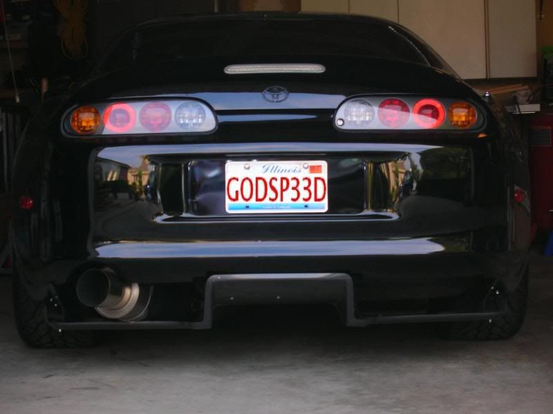

godsp33d's rear diffuser will help with keeping the rear end planted at high speed, due to the fact that the air moving over the top of the car is moving faster, and therefore has a lower static pressure than the air moving underneath the car, resulting in lift. the faster you go, the more lift is generated. the diffuser helps by smoothing together the airflow from the top of the car, and the airflow underneath the car, when the air below hits the diffuser it is sped up and instead of lift, generates downforce. plus the diffuser looks badass
btw godsp33d, what diffuser is that? and what exhaust are you running? did you have any clearance issues with the install?
its the TOP SECRET rear diffuser directly from japan in which i waited 6-7 months for! So if your on a time frame you better order in advance!! Also, Top Secret has proven that their rear diffusers do actually work, i'm not too sure about other designs. Ive heard that some people have some fitment issues with others. Top Secret has designed this rear diffuser to be an actual function to the car as well as looking bad ass! There are actually numerous threads on the diffusers.
http://www.supraforums.com/forum/showthread.php?t=426414&page=6
Im current running the HKS Titanium w/slight modification to the diffuser, nothing someone cant do on their own.
