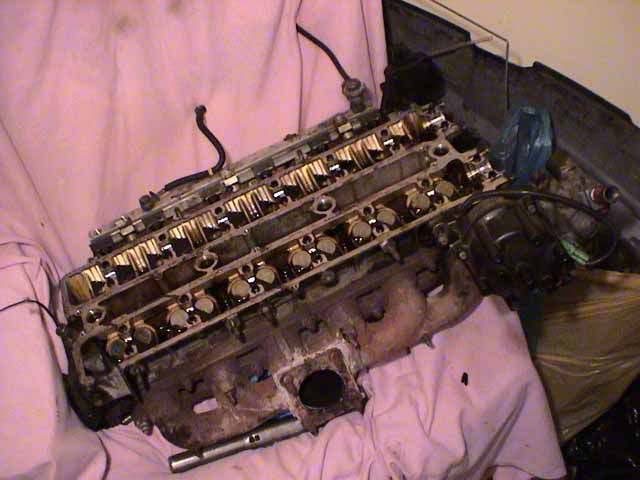

so its time for a refurbishing of sorts. tell me what you think. Is it as bad as i think you think i think it is???
what do u think of my camshaft?

I nocticed cams off my engine with 240,000 miles and jdm engine had all those same scratches, seems to still work fine.

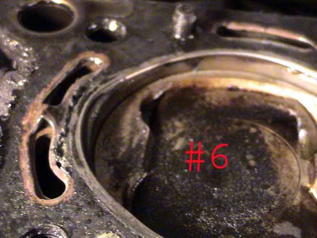

DAMN you blew the gasket on every single cyl. WAY TO GO!!!!!!! 1st time I've seen that. I went back and looked at the pics again and noticed you are na->t so that would explain how easy it was for you to blow a stock hg. Time to do the mhg huh? and start looking for another set of cams.
yea, it shouldn't be that bad, since they don't have bearings like the bottom end does, it doesn't effect it that much. just maybe a little more valvetrain noise...

engine has 127K miles on it... about 10k of those are boosted, and about 3000 at 11psi.
ya, i've got some things planned. MHG is definate

So was this one of the "sudden" blowings or a symptom here, a sympton there, then a bunch of little syptoms? Sorry to see it. I do hope you aren't suprised though.....

definately a sudden blowing. I was scewin around, and my friend said he felt the car jolt a little. I didn't even notice. As soon as he said that, my eyes moved the my temp gauge and it was on its way up.
The car idle'd a little rough on startup, but didn't blow any smoke. I did a CO test, and it read positive when i revved the engine up.
edit: i'm not suprised. I've been waiting for this day for almost two years now. I knew it was coming, just didn't know how much boost it would take

I don't think your cams are screwed up. The cam saddles tend to put some buildup on the cam bearing surfaces. If you use a dremel with a polishing/buffer brush, they'll polish perfectly smooth, as the 'grooves' that you see are just a softer material deposited on the cams. You might want to leave it as is, though, so that you get a tighter fit, and less oil pressure loss.

wow thats bad. proof that detonation is a hg killer. just be thankful thats all that let go.
