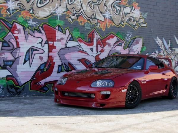

My Supra: Plain and boring
Sfitts2380's Supra: (My ideal stock body Supra)
