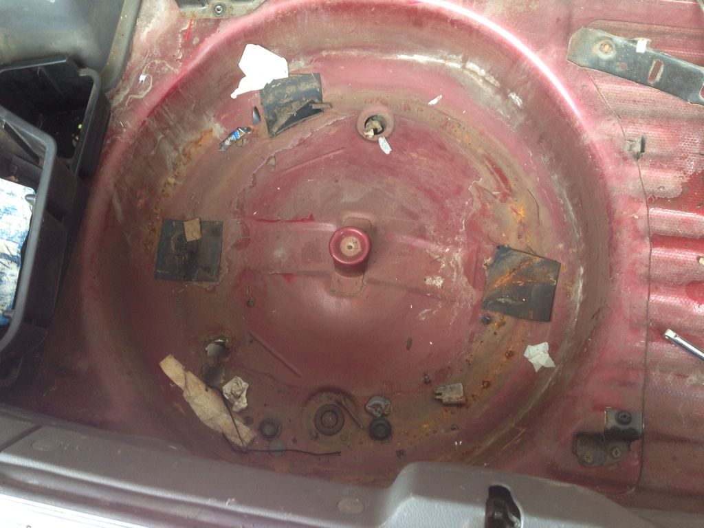

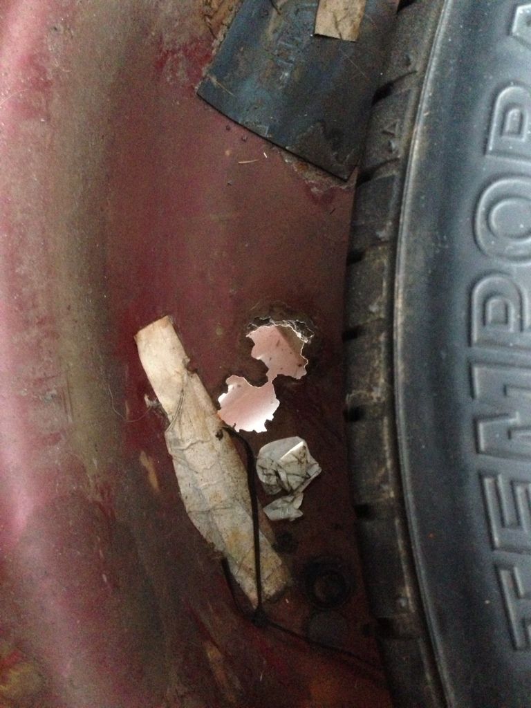

Spare tire well:
ok so to start here is the rust in the spare tire well. it is usually around the edges right under the tire.
Trunk drop off

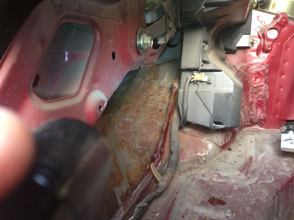

When your going to look at a supra make sure you take off the little plastic removable panels on both sides of the trunk and stick your hand down in there or take the whole panel off and get a better look. If you feel rust or water its usually going to cause holes. these holes are in the metal behind the rear plastic bumper.
this is the inner wheel well on my driver side. my passenger side is clean.

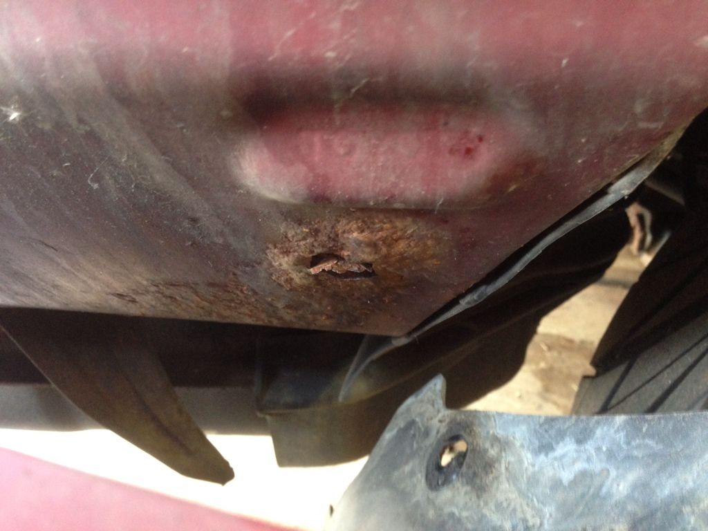

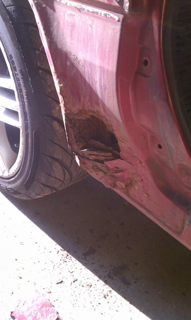

Plastic Mud flaps in front of the Rear Wheels
ok so these were really bad on my car. if you take off the plastic vent thats on the door sill and use a flashlight and look into the hole and you see rust then take off the flaps and be prepared. You can see the black vent you take off in this first pic. this is the driver side:

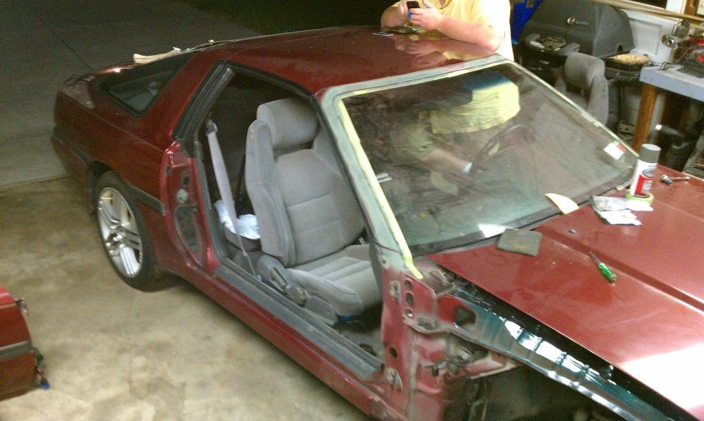

Around the Windshield and Around the Targa
now i dont have pics of before but i have an after that been grinded and prepped but it will look like little bubbles under the paint

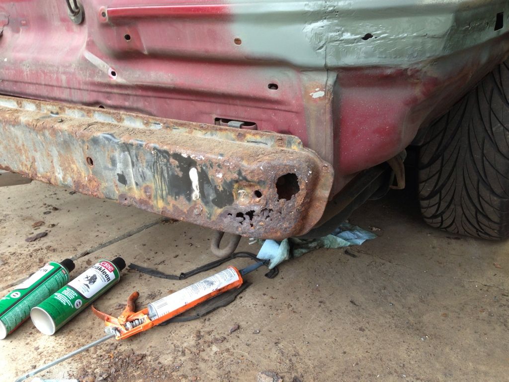

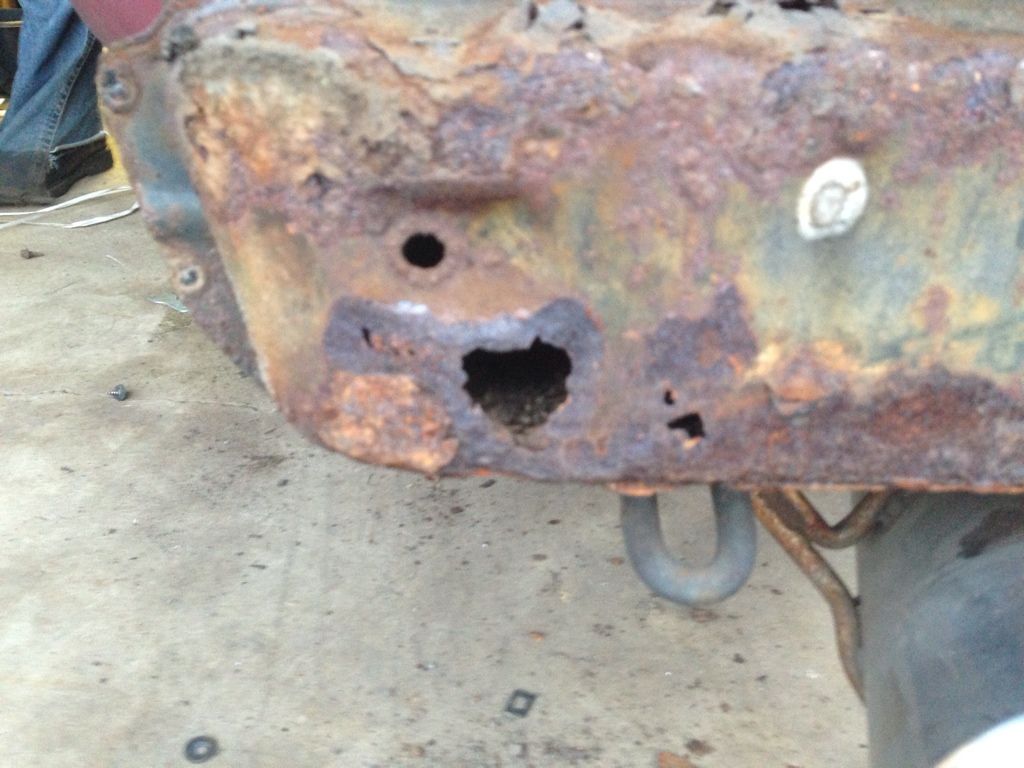

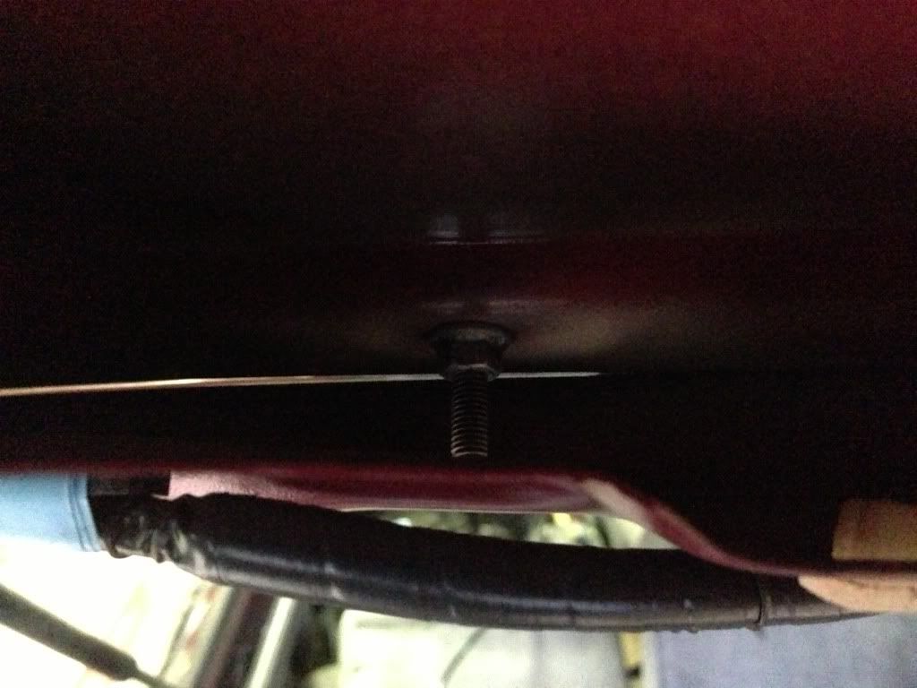

Rear Bumper Support (Crash Bumper)
now this one suprised me. as i was taking off the back bumper all the little bolts that hold it to the support were breaking and only 1 came out. So as soon as i got it off i figured out why. and btw this is very unsafe

this plus 2 others are what hold the bottom piece of trim on the hatch down

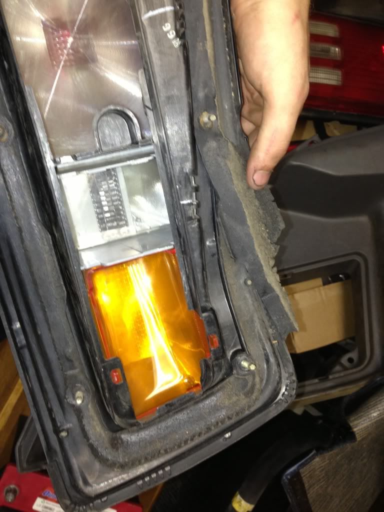

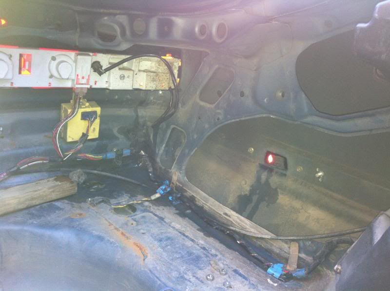

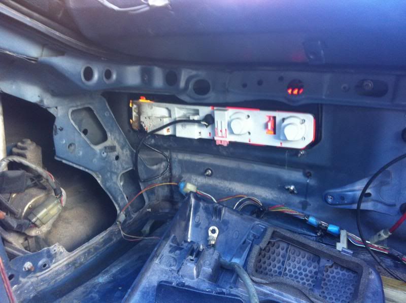

this is the tailight gasket that wears out and gets brittle
The death of these gaskets can be dertermined by opening the trunk and removing the plastic interior panel that will be over head, under the hatch. If you notice the hatch leaking while opening the hatch or if you find water behind said panel - your lower hatch trim is leaking. If not, your tail light gaskets are leaking.
By this being said, if you find one of the rust spots you found in your trunk/quarters the other side should have a simular result.
Also what can be blamed as a minor problem would be the rubber cups your body trim clips into. If these have a chunk missing out of them it can possibly cause water to slowly drip in the cabin.
This water will natrually migrate and pool to the lowest points of the trunk. If you find water at those points, they are drain plugs at those locations. Once the water is fully removed and dry, undercoating that area would be wise.

Also, I recently rebuilt my tail lights and left the trunk interior out of the car and while I was washing the car, I get in to get my shammy and I noticed my hatch lid, trail light gasket, rear marker light gasket AND one of my body trim rubber cups leaking! So I took a few pics on my phone but I don't have itunes here so I'll let you know when there uploaded lol
It's fucking brutal

87supramario said:
So finally I got to upload these pics and can't post in the thread because it's been moved to FAQ lol
If you can post these, look closely at the leaks. The rear side markers are leaking as well as the tail light gaskets and even those little rubber cups the plastic clips clip into to house the body trim!
In that last pic, above the leaking rubber cup, there was a drip of water that was dripping off the tail light that was captured in action in photo. It just looks like a white line really :sad:
