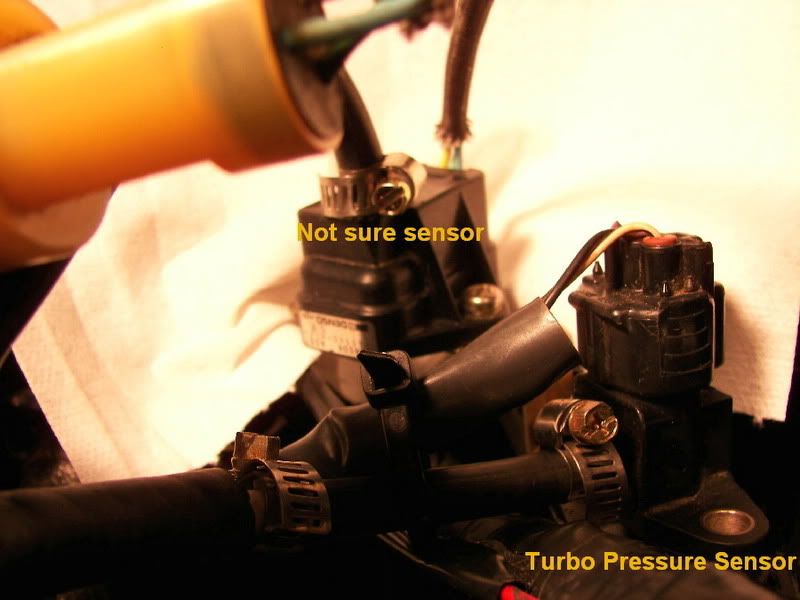

Nobody seems to know the name of this sensor. I didnt follow the wiring yet but I believe the vpc connects to it. Anyone recognize it from these pictures or the denso part number showing? Part# search at local toyota turned up nothing?
Do they use non supra denso sensor when installing vpc's? I didn't install it.
You can see the wire and Large wire connector coming off it in picture 2 & 3.

Anyone know where these are sourced from? Apparently is not a stock denso part number for our MKIV's. Do installers source them off another model/make?
The sensor right next to it in my pictures IS a stock MKIV sensor ( Turbo Pressure Sensor ).
I looked up a VPC install write up on MKIV.com and it doesn't mention the sensor I questioned above. It only mentions the MKIV Turbo Pressure Sensor being used.

Sure the mkiv install install instructions show this sensor, it's shows with a yellow hose connect to it. Again this sensor comes with the VPC, it is not a Toyota part. As to buying them, I believe they are hard to come by since the VPC is discontinued.
1,638 Posts
Jon your going AEM right? You will not need any of those sensors if you do. You will replace them with a 3.5bar or 5bar map sensor from AEM.
