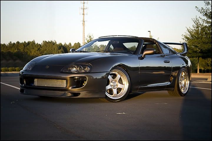

i got it done on a RMM lip, wouldn't suggest you do the same. It sticks better on painted surfacese, but still in time it starts to come up in spots and a PITA to keep it down. Also, if you ever scratch it pulling out of the driveway, stuff comes right off. Looks decent though.
(old setup)
