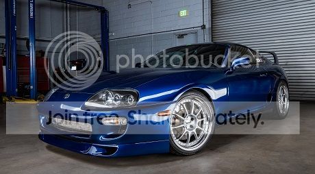

well, here she is, 95% finished - just waiting on the odd bit of machining, and some intake connectors etc. 14 months in the making, and a lot of effort by a lot of people to get her here. A big thanks goes out to:
-Wilkins Performance Engines (Graham Wilkins)
-GT Tooling (Geoff O'Toole)
-Stuart Wilkins
-Phil Riles
-GK Tooling
-NAS Automotive
As well as the friendly folks of:
www. toymods .org .au
www. performanceforums . com
www. eng-tips . com
notably:
-gianttomato
-rob_ra40
-stenno
-gts_boy
ENGINE SPECS:
-7M-GE 3.0L 24v DOHC I6
-83.5mm bore 91.0mm stroke
-7M-GTE Block - oil squirters
-ported and polished port and chamber
-ported and matched manifolds
-custom upper manifold with cobra twin 57mm t/b
-FGK tuned mandrel exhaust manifold
-Custom machined pistons and block
-HKS 1.2mm metal head gasket
-10.7:1 static compression ratio
-bottom end: ground, balanced and polised and blueprinted
-ARP b/e fasteners
-MSD superconductor leads
-TRD clutch
+lots of little custom machined bits
for more details you can read this thread :
http://board.performanceforums.com/forums/showthread.php?s=&threadid=67166059
