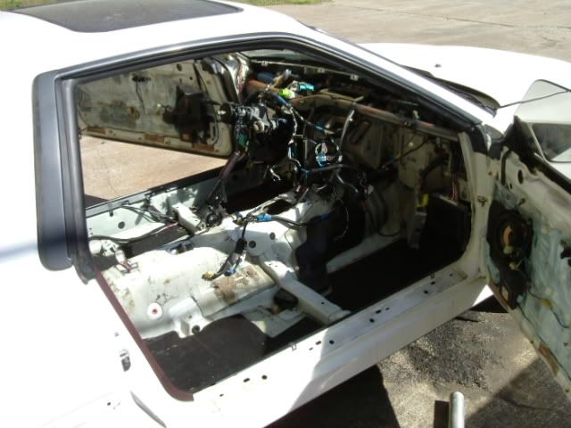

- Before removal
-First thing remove the dash. There's no easy way to do this and the best way to learn is doing it. There are many wire clips taped to the back of the dash that must be removed. Its hell no matter how you do it and going into detail would be pointless. Learn by doing............I removed the whole interior for a color change........this is not necessary of course.

- Before removal
