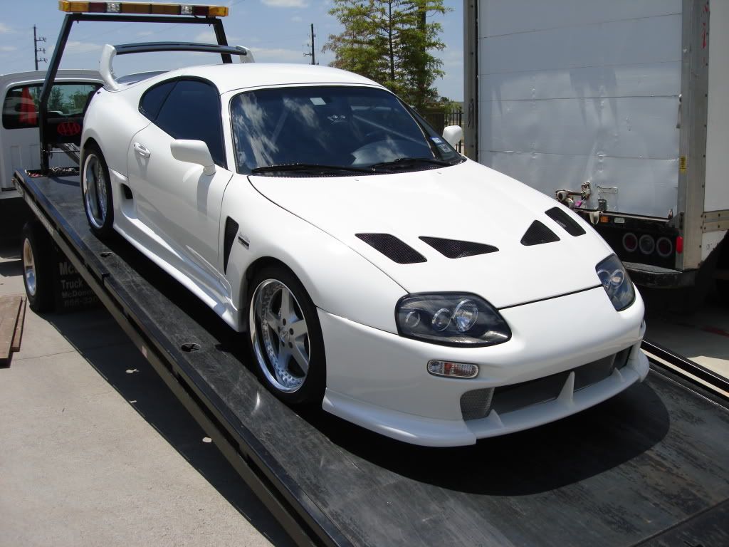

Oh, and a side note, we took about an hour to figure out how to load the car on a wrecker. It took a lot of wood and we had to load the car backwards!!!ohnoes:
This was a laugh but we got it to my garage with NO damage:
That was the worst / hardest towing experience I have ever had. Breaking down on a Sunday when the wrecker services with REALLY low ramps are closed is not good. Had to make due:biggrin:
