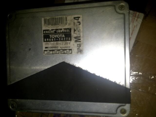

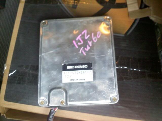

so we have two supras.. and just brought these home:
they should be dropped in this weekend
we ordered them through a friend's shop that normally messes with 240's.. they came with one ecu plugged to one harness that had 1jz turbo wrote on it.. they sent another ecu a couple days later that has '1jz-gt' printed on the sticker for the second motor.. the guys at the shop said it wouldnt plug up so they were trying to find the right one for us
does anyone have a picture or can tell me what they should have on them for a jza70 m/t ecu?
ecu 1:
ecu 2:

idk about that first ECU, but the second one definitly looks like a soarer/chaser ECU. The pins on the JZA70 are different than the soarer/chaser ECUs and they don't have that extra set of wires coming out of the ECU. Are both the engines out of MKIIIs?

the top ecu was plugged into one of the motors so i'm pretty sure its correct and a m/t.. just didnt have the 1j-gt m/t sticker like most of the ecu's i was seeing online
the bottom one is def. a jzz30 ecu after doing some more research.. it wouldnt plug up anyway so i knew something was wrong lol

The easiest way to tell is the JZA70's have 4 ECU plugs with 2 rows of pins.
