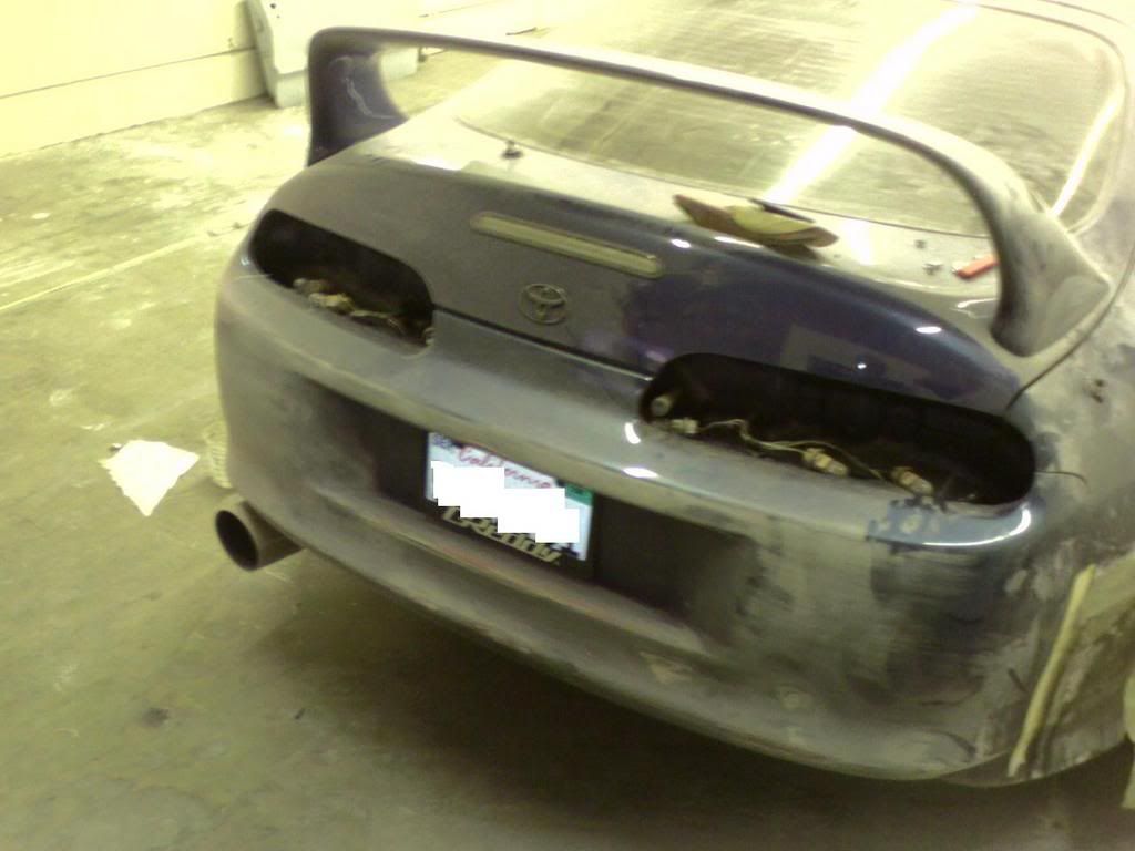

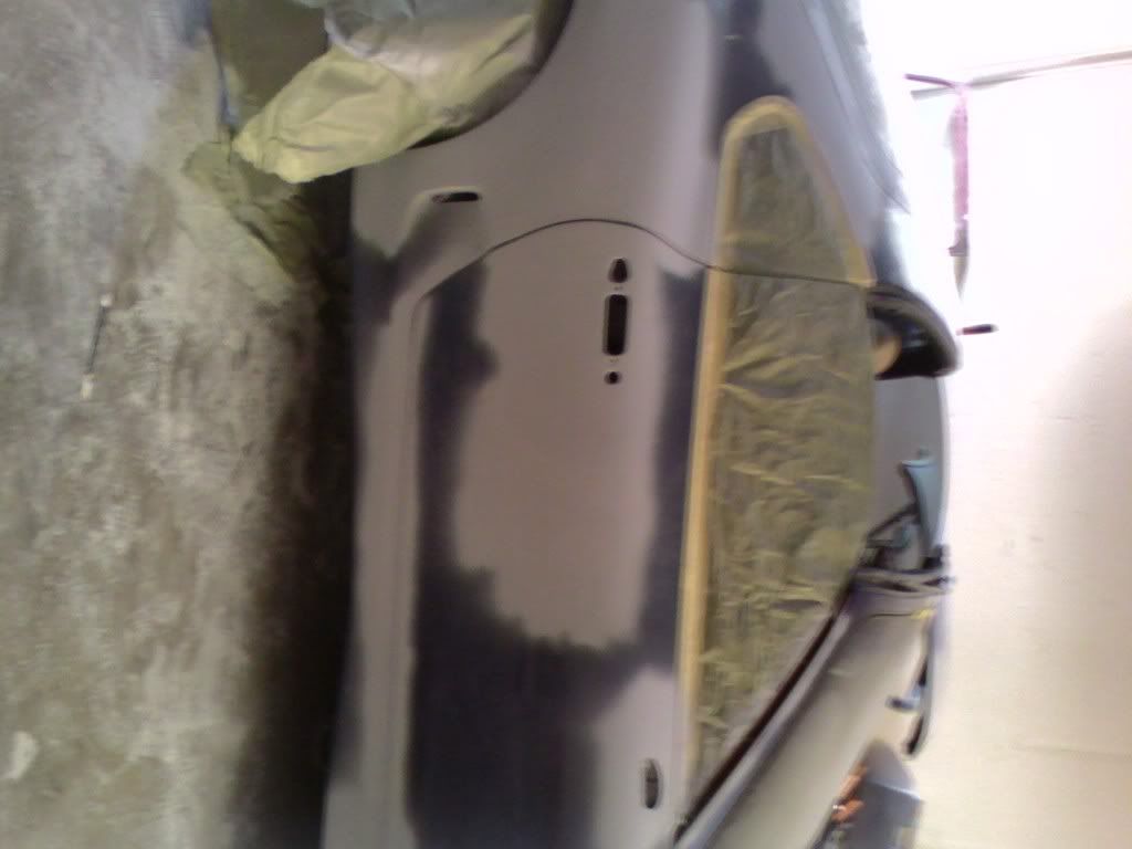

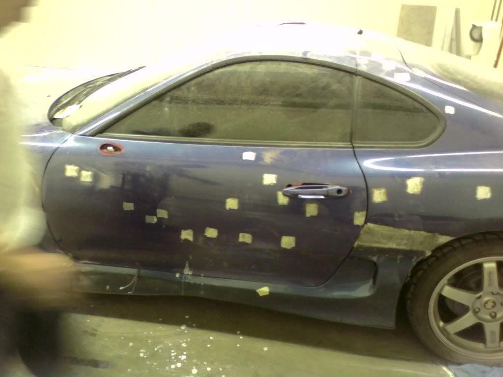

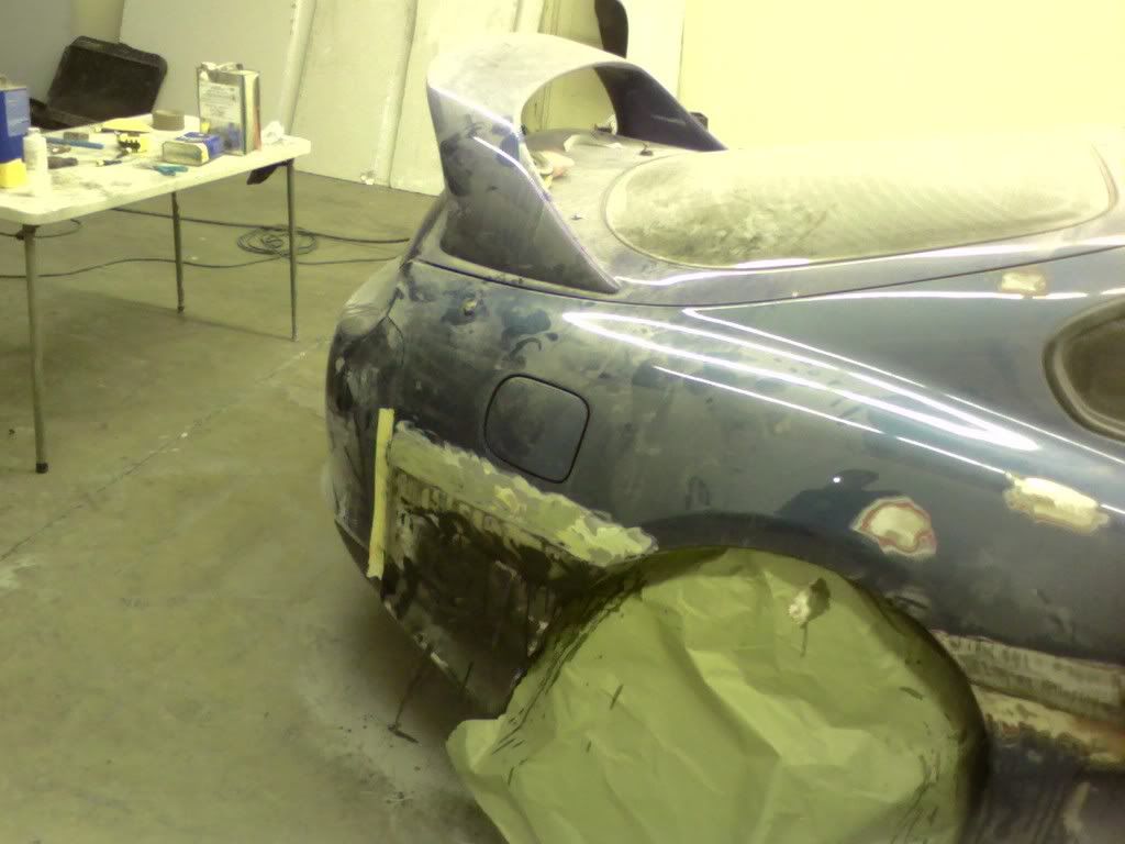

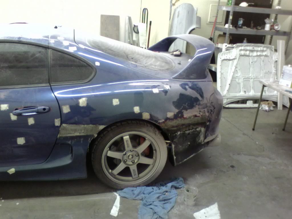

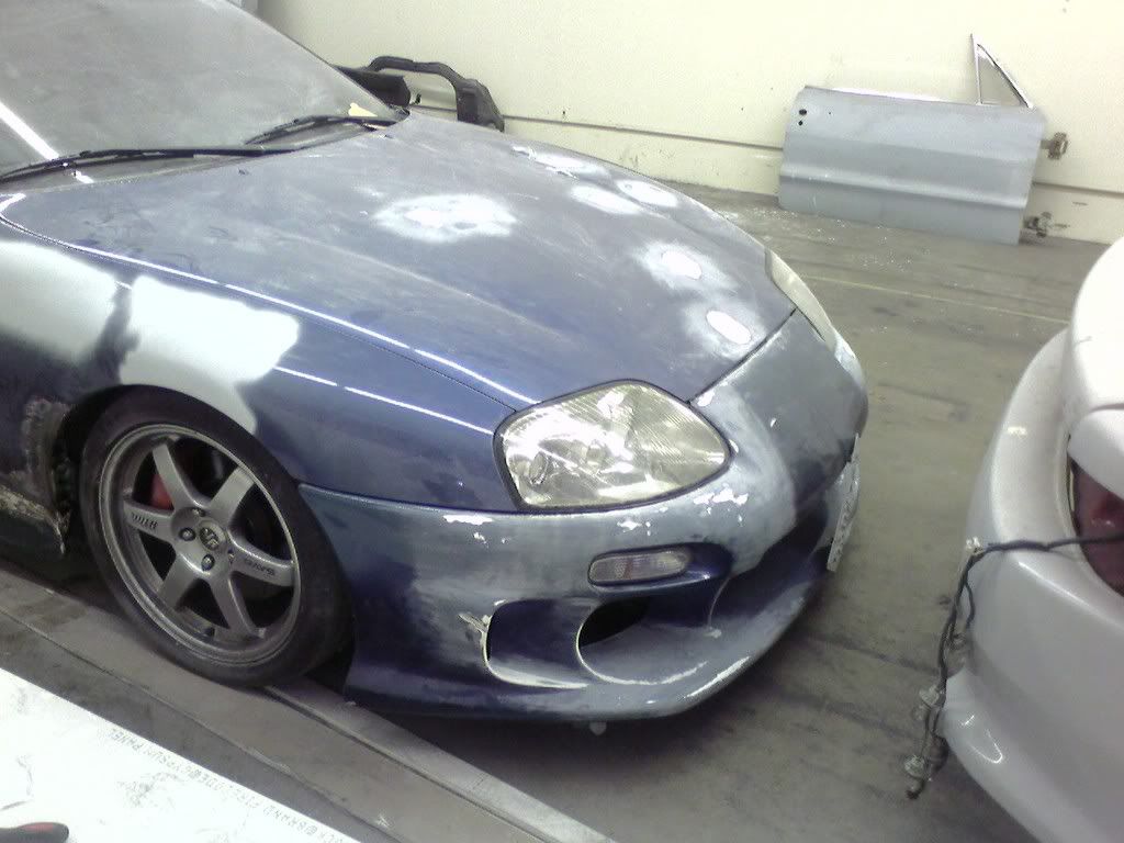

Hey guys,
well i took my car to my friends shop and we painted the whole car. We painted it RSP color. Well took about 2 months, but really only 1 month of working on it. Check it out, hope u guys like it.
Before:
Body shop:
Those are all the pics i took, there was about 100 more steps, but yea didnt have my cam lol.

Things done to it:
Shaved off everything- emb, rear wiper, antenna, water nossel
molded everything- rear and side skirt
painted engine bay and all the plastic pieces
painted the plastic piece below the windshield jet black with the wipers also
fix all the dings and dents
wat am i missin lol??

overall car looks great, but has your friend ever heard of actually pushing ,massaging and working out the dents instead of covering them up with bondo? and what's with grinding all that to bare metal? some butcher got a hold of a grinder? tell him to invest in some PDR tools, that will save some time and keep the car bondo-free, that's what I usually do, I work all the dings and dents out and just block existing paint if needed and if I bust trough the paint, just shoot light coat of primer
and I see engine bay is still not painted as said, good job nonetheless

lol, well ok, i didnt show u all the pics, he did grind them down and pulled them with a dent puller, then put bondo over them. dude i have no idea what u are talking about lol
