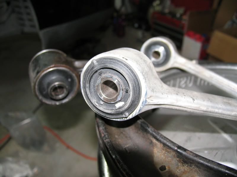

I just pressed some new bushings in and out recently. These were copies of the stock bushings from Andrew Vlamos http://www.vftbushes.com/
I did the rear/front upper and the front lower. The front upper are very easy to push out with a long bolt/nut and some creativity.
The rear uppers were harder since they have the outside sleeve. I was able to pull them out and press the new ones in without pulling the arm from the hub, which would have been a bitch. Just pull the two bolts and swing it around. I found a NPT threaded cylinder in the plumbing section of Home Depot that was a perfect fit. Large enough to fit over the lip of the bushing sleeve and small enought to press on the rim of the control arm.
I had to push the rubber out of one of the bushings (leaving the outside sleeve in the control arm) and then very carefully cut a slit through the sleeve to get it out. Just don't cut through to the aluminum. I used that sleeve to press out the other bushings. I bought a long bolt, some strong washers and with a little creativity and an impact wrench, I was able to push those out and get the new ones in.
The front lowers were the hard ones. I took these to the shop my brother works at and used a press to push them out. Luckily we had a lathe and made a tool to fit on the rim of the bushing. I could probably do this now in a quarter of the time it took the first time! I'm not sure if you need to push the outer sleeve out with those R2 bushings. If not, the inner sleeve and rubber shoudn't be any problem for you to push out with a press. The hard part if with outer sleeve.
