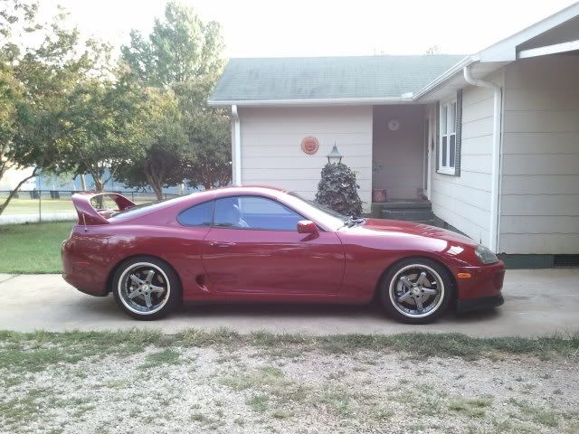

here is the car when i first got it. yes those are 20's!!!
car is a factory 1995 supra NA/5 speed. previous owner installed an aristo gte with a ebay gt45 turbo kit. not tuned, ton of oil leaks, blown struts, rolled rear fenders with a pole..terrible job, also had a wings west front lip that looked as if Stevie Wonder cut the wings off of it.
