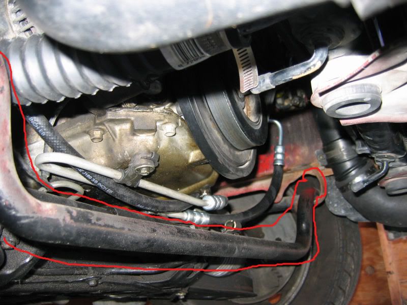

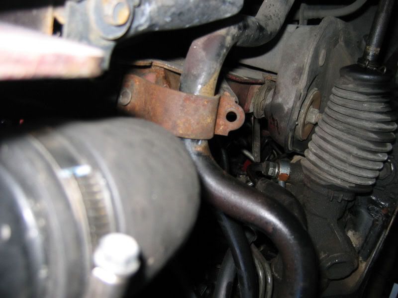

Just wondering what this is, and what I can do about the problem I have with it.
Seems to have a bracket on each side, though 1 is missing and the otherside is missing a bolt and bent downward, this entire bar can be moved by hand a Lot.
Is this some kinda stock swaybar or something?
what would jesus drift?
987 Posts
you get mad body roll with the mounts broke like that huh!

I dunno, I have only driven the car like 2-3 miles down the freeway, then in town to my house.
I'm waiting to get my exhaust put on before I really start to drive it, Open DP 1JZ in Cali = Cop magnet.
So, I guess I can just replace both those brackets or whatever and be good?
987 Posts
make sure to replace the bushings..
their probaly missing with the mounts like that., but yeah i belive you should be good to go with that mounted back up their firmly

Allright cool.
Ya I pushed the car once and heard some clunking noises, didnt know what it was at the time though.
Thats why I only drove it from my work to home, and put it right in the garage. It's next drive is to the muffler shop.
I take it the "Bushings" would just be a rubber piece that goes between the bracket and the bar itself? Or something to that effect....
yep,probably $3 each at toyota
^ I'd replace both brackets & 4 bolts along with the new bushings as the brackets might have gotten bent or fucked-up with the bar rubbing on it.

Local dealer wants fuckin $13 for each bushing and $20! for EACH bracket, fuckin insane.
Hopfully Elmhurst can do a little better.
