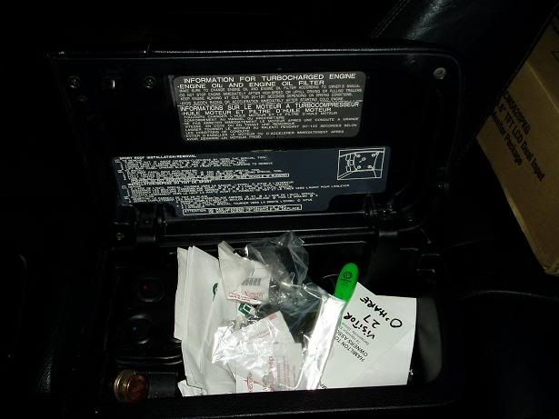

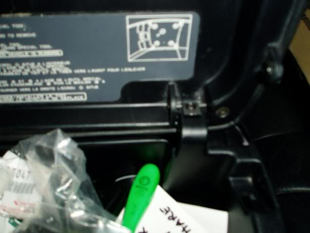

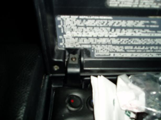

Alright guys/gals, I've been getting a lot of PM's so here's a repost
*****ARMREST Nice Cheap Fix*****
Things you need:
2 black shelf clips - .07 each
2 little screws .05 each
mini phillips screw driver - .50
needle nose pliars - 1.00
and a brain (priceless) :)
1-Take the top lid off (mine was already broken off)
2-Take the little pins out with the pliars (pull them off to the sides)
3-Put the self clips where the pins where then put the pins back in
(this because the pins don't have enough room to fit)
4-Hold the Lid where you want it and screw them on the plastic bracket
Wahllah!
Enjoy! - HOPE THIS SOLVES YOUR PROBLEM

Any way you can give more detailed photos? I want to try this mod soon, but don't "quite" get how the hinge is attached by those shots. Mine is broken clean off, and this would be a superb way to save a few bucks. Thank you.
