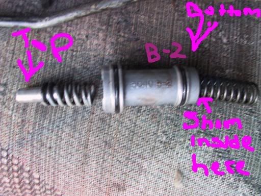

This is the first accumulator stretched out, the trick to getting them out is to push them all the way down and let them pop up... only way I can get them out.(this is the b-2 accumulator 1-2)
This is the bottom side of the accumulator(the one without the solid rod, that would be put in first going back in) This is where you want to place your shims, you want the shims to be about 1/3 of the spring travel, unless you don't care about you neck and you're tires breaking loose every shift.

Sorry about the lack of clarity in the shim placement, hopefully these two pictures help. Also, for the first transmission we used standard flat washers, but for the transmission Im prepping now, Im going to use barstock and have it machined. Also for kevlar clutch's, I've not yet built a transmission with them, we've used Toyota parts, the Tundra has 350hp to the rear wheels(it is supercharged) and he beats the hell out of the truck, and the transmission is still going strong. After I swap the transmission out of my car, that one is going to get full kevlar clutch's, and will be built considerably.
Again, this is b-2, but with the area's labled. When I refer to "top" It is the part that is visible when you are looking down at it(the one with the metal rod inside the spring)
The shim goes inside the accumulator, the purple mark is the "shim". This doesn't matter if it is solid or open, just as long as it makes full contact with the spring.
