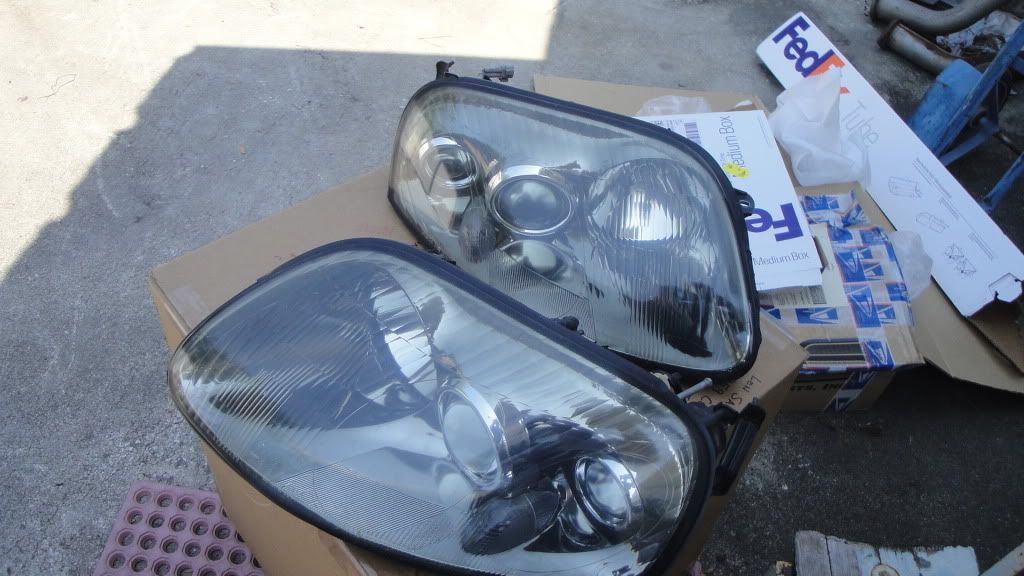

Right out the box as I received them

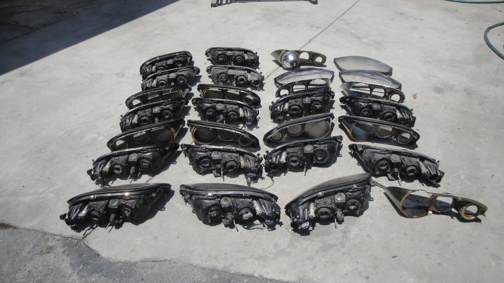

Just a few pairs of headlights I'm working on

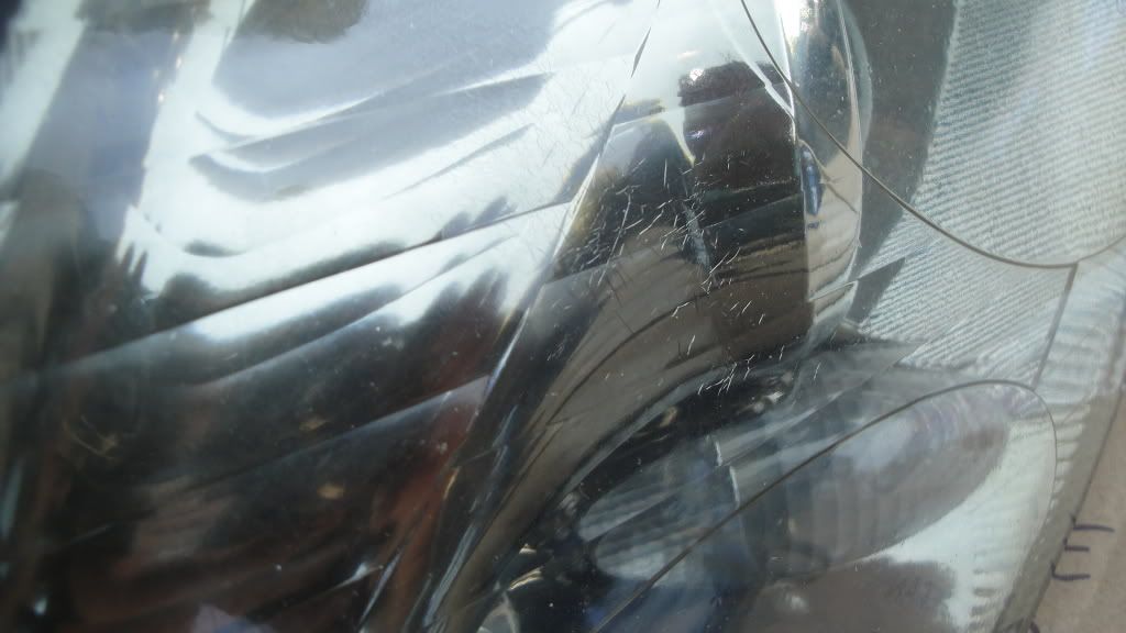

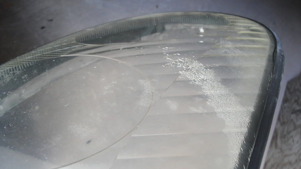

Here are some of imperfections in the lenses before I start working on them

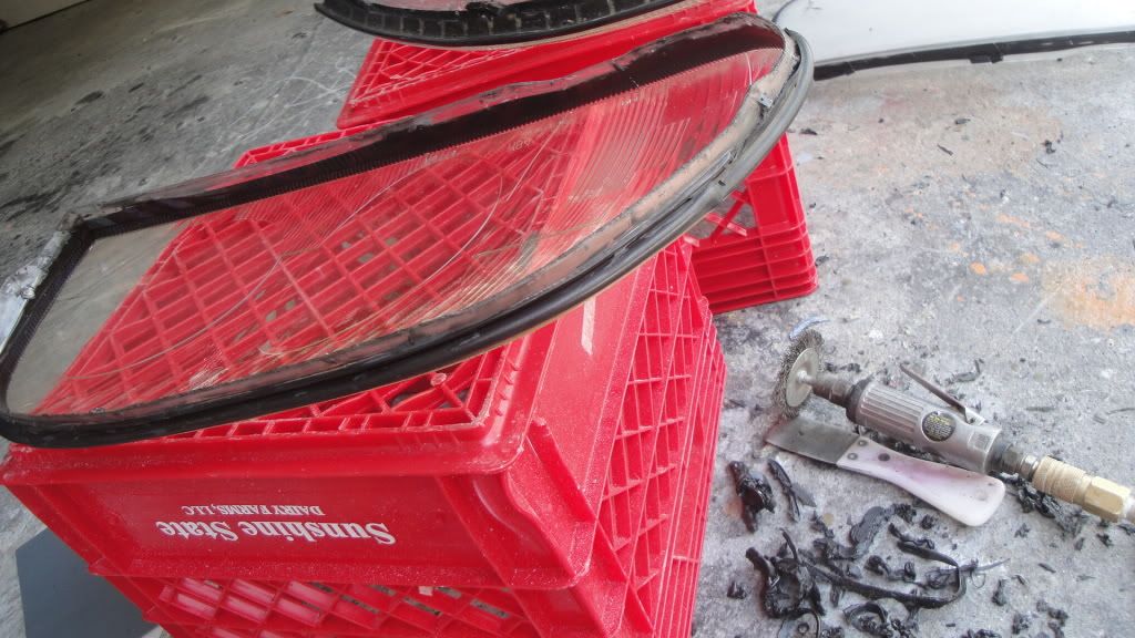

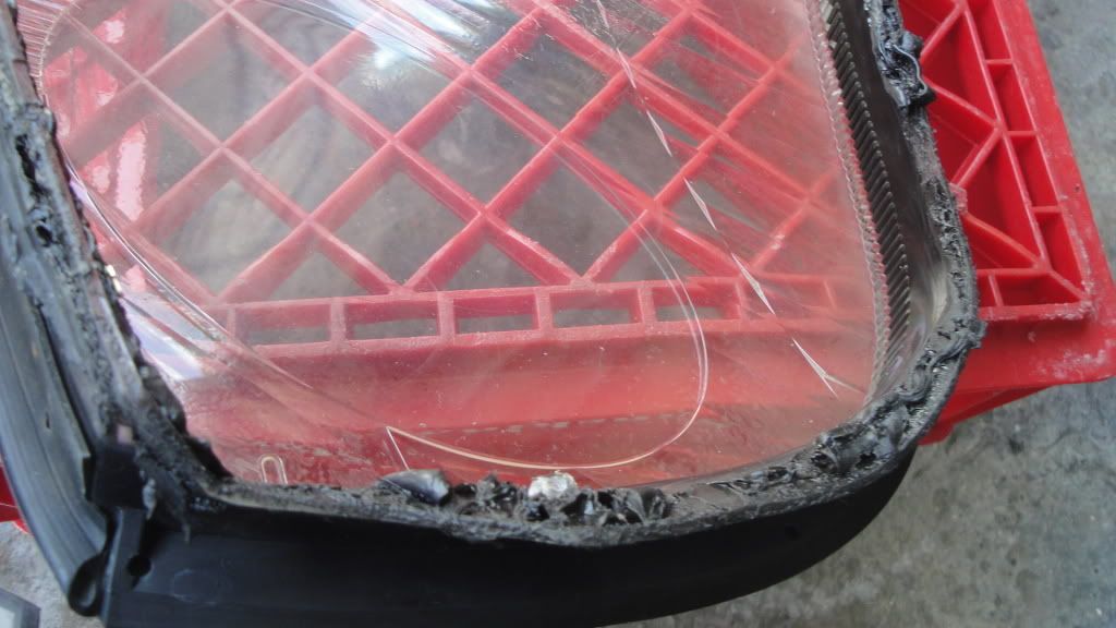

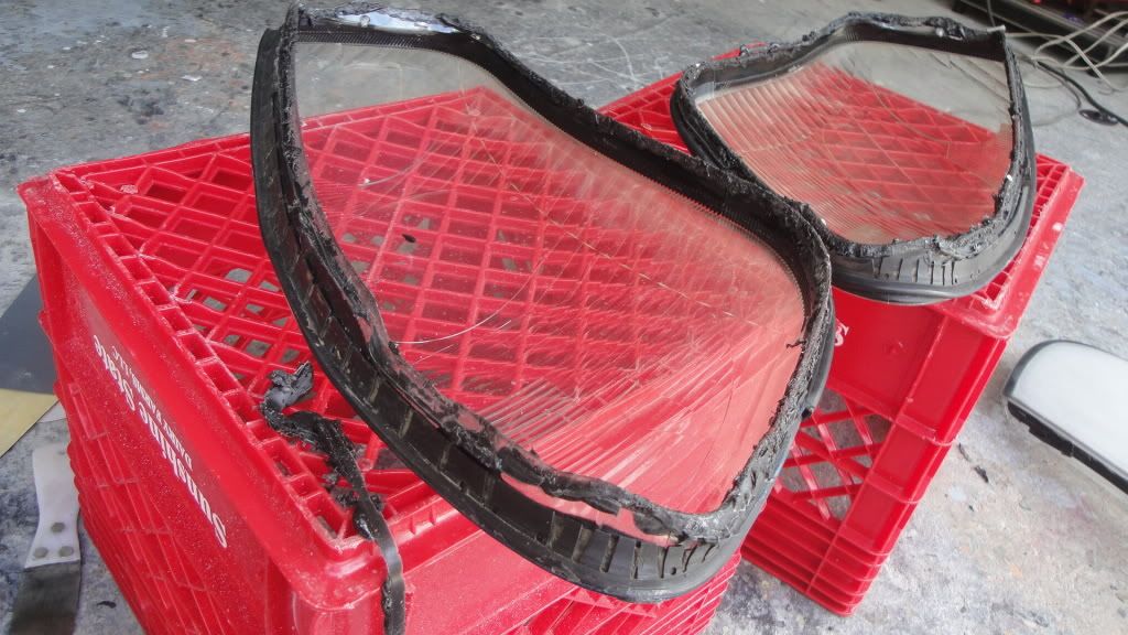

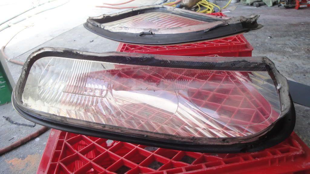

Someone had previously opened them and without properly cleaning old sealant used silicone to reseal them,so I had to get all that mess off

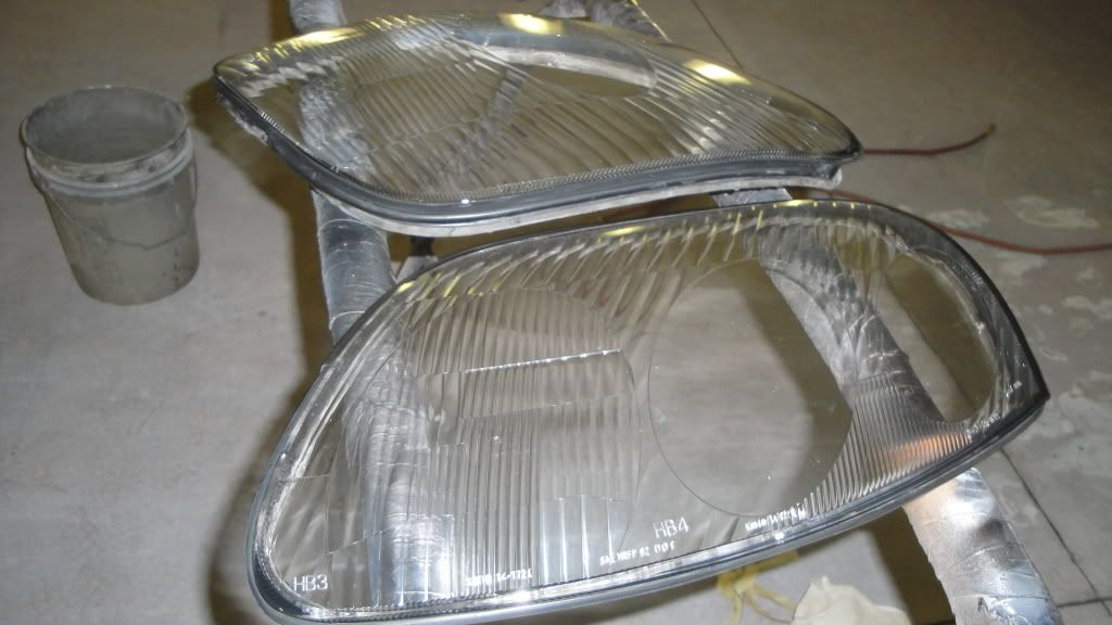

Sanded out imperfections and cracking on lenses ,clearcoated to keep them looking fresh

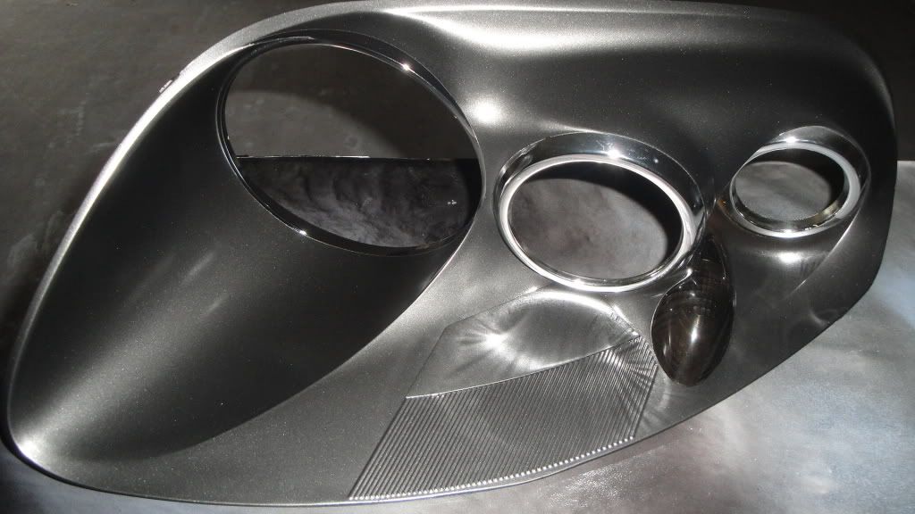

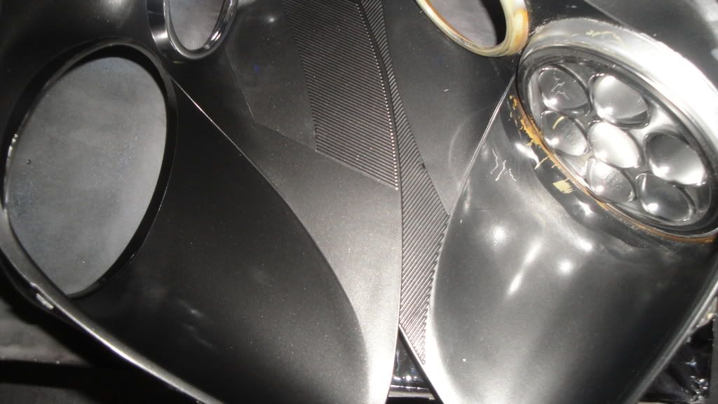

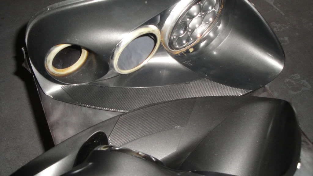

Prepped the inner housings ,masked off the chrome rings and edge of high beam area to give a little detail and have somewhat 97-up look as well as tinted the bulge lense so it won't stick out like sore thumb on dark background
I tried to get the color matched as close as possible to 97-up housing (pictured on the right) and I think I have succeeded .At some angles it changes colors because of the pearl metallic and you may notice slight difference.I have played with the paint for about an hour and I'm happy how it turned out,because I don't think the match would be any closer.
