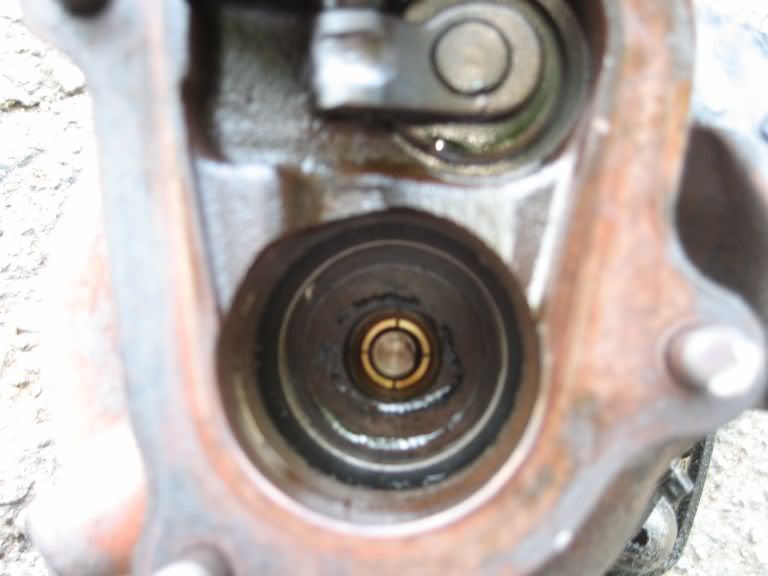

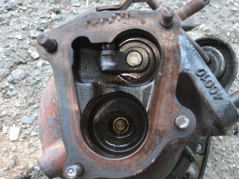

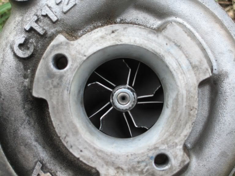

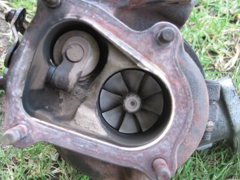

So yea, running the stock 1j turbos for little over a year now, and yesterday it blew up on me, my turbos were smoking from the beginning, but I had to use a high flow cat to cover up the smoking issue. so here's some pics
Turbo#1:
Turbo#2:

wow! is that common to have the rear impellar fly off like that?

You know it...lol...when I saw yours, I was thinking it was going to be a matter of time....but to think about it now, my theory is that when the 1j turbos are smoking, I think it's due to the rear ones......

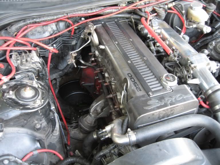

oi. headache central. I did it once with the engine OUT of the car. Don't wanna think about doing the job with the engine in the car...

Joe is correct, I originally had to take it out once to install the y-pipe/downpipe combo(that was a bitch); then I worked my friend's 2j, removing those turbos and the vaccum line system was more a pain in the ass than the 1j(cuz i had to swap out the jdm turbos out for USDMs), so in reality, the 1j was a walk in the park compare to the 2j, it took me 2 hours to remove the entire 1j turbo setup because I knew what to do at that point(it would have been faster but I was tired as hell from waking up hella early).....but yea, I just got my manifold today, and test fitted, that shit is off the hook, I can wait to get a turbo on there.....
