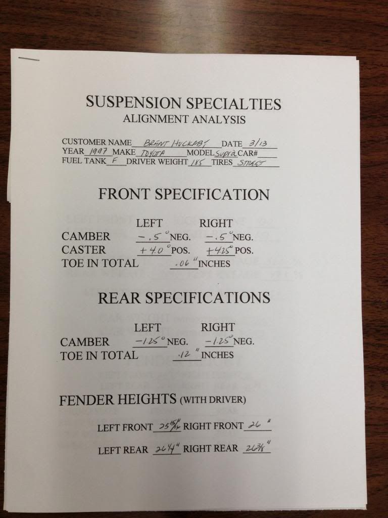

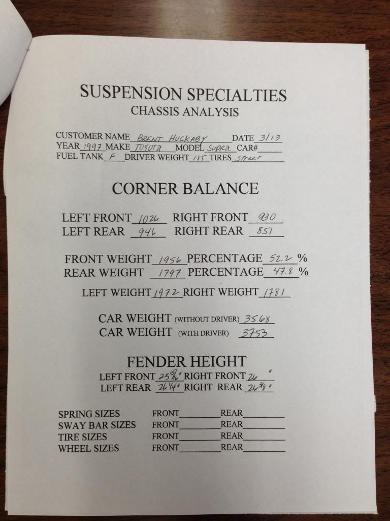

#12 ·
I don't have a stock suspension and my wheels are not stock size. So this info might not suit everyone, but I gave the Lance alignment figures to my alignment shop and they didn't care for them much and said it was closer to a front wheel drive car specs. Below are my settings if your interested in a great handing Supra that will not tram. My set include KW V3's, TRD sway bars and 9.5"X19" front and 11.5"X19 rear.
