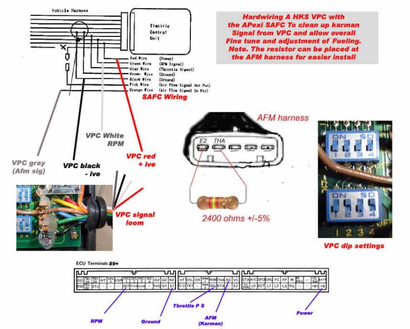

When u cut the afm wire from the ecu in half, pink wire from afc connect to the cut off afm wire closest to ecu and vpc gray wire connect to afc orange wire, my question is what do u do to the the other end cut off afm wire? This is for a 90 supra turbo.
