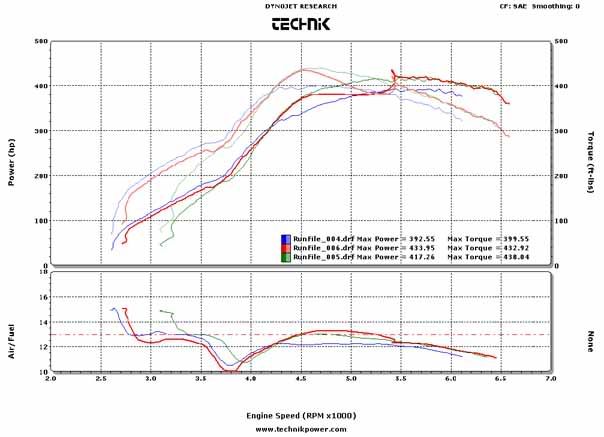

100 octane, 21 psi , 89k mi stock slipping clutch
434rwhp
the red line is the 21psi run, notice how there is a massive spike and dip due to the slipping clutch.
i'm confident we could have made 440-450rwhp if i had an upgraded clutch
thanks to anthony (ammo) at Technik for they dyno tuning, zolti and anthony do great work!
Ian at "The Shop" for the vpc chip
Ryan @ "ryan's home" for the afr install
and Vic Martino for the VPC
mods are listed on the sheet below

Mods: vpc, cai, afr, jun cam gears, cf ti hks exhaust, hpf 3row fmic, apex intake, blitz sbc-id,

Nice numbers but by looking at the A/F chart at the bottom you are running rich between 3,500 and 4,000 and too lean between 4,250 and 5,500. I am not to knowledgable when it comes to A/F but most people seem to run in the mid to high 11's and you appear to hit into the 13's :dunno:

Nice numbers, im assuming the flat a/f curve at ~12 is your final tuned run? Does your boost hold until redline?
I didn't even see that line but I would assume so, regardless the numbers are very good. Update us with new numbers once you get your new clutch.

at 19 psi the ar is 12:1 all the way to redline
however
at 21psi the a/r started leaning out and my clutch gave... thats when we stopped tuning
basically when i get a new clutch in, i will add a fuel pressure regulator and richen that spot up before additional tuning. i don't plan on running 21psi too often, and deginately not before i get my new clutch in, but thanks for the compliments
like i said 450 rwhp would not have been a stretch had my clutch held =(

Curtis, as I already said you car def still has more in it man. Let me know when your ready to clean things up a bit more and dyno your baby again. Thanks for the kind words man. :bigthumb:
