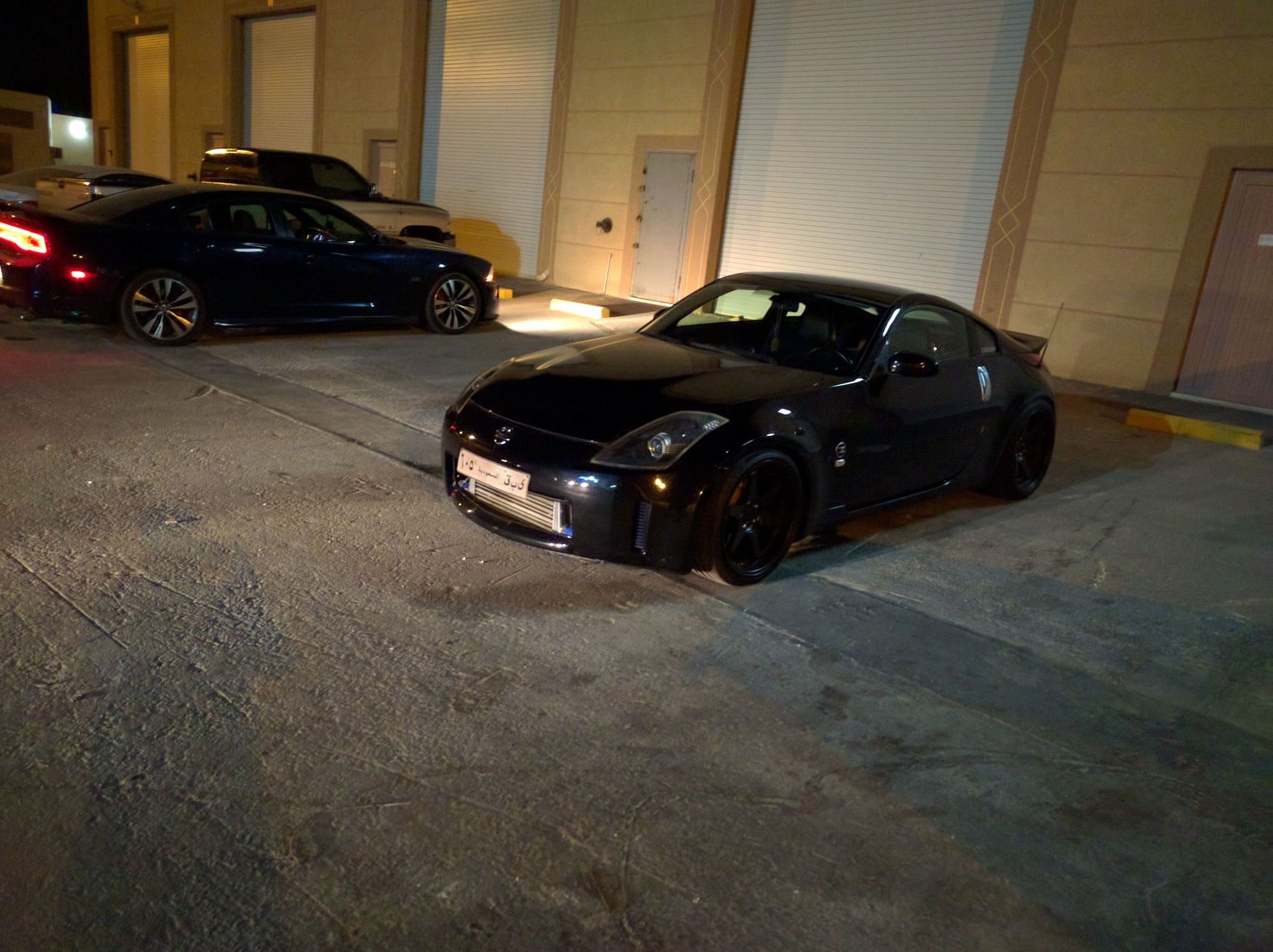

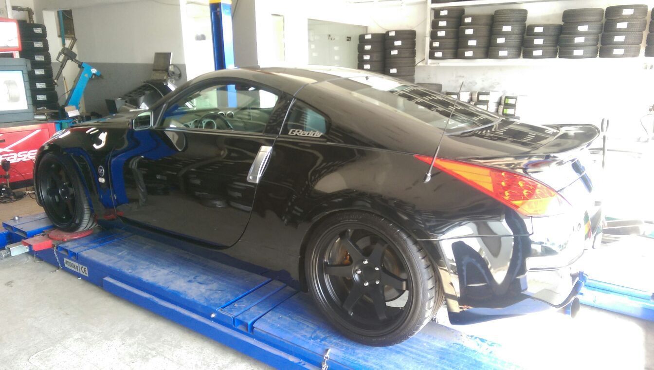

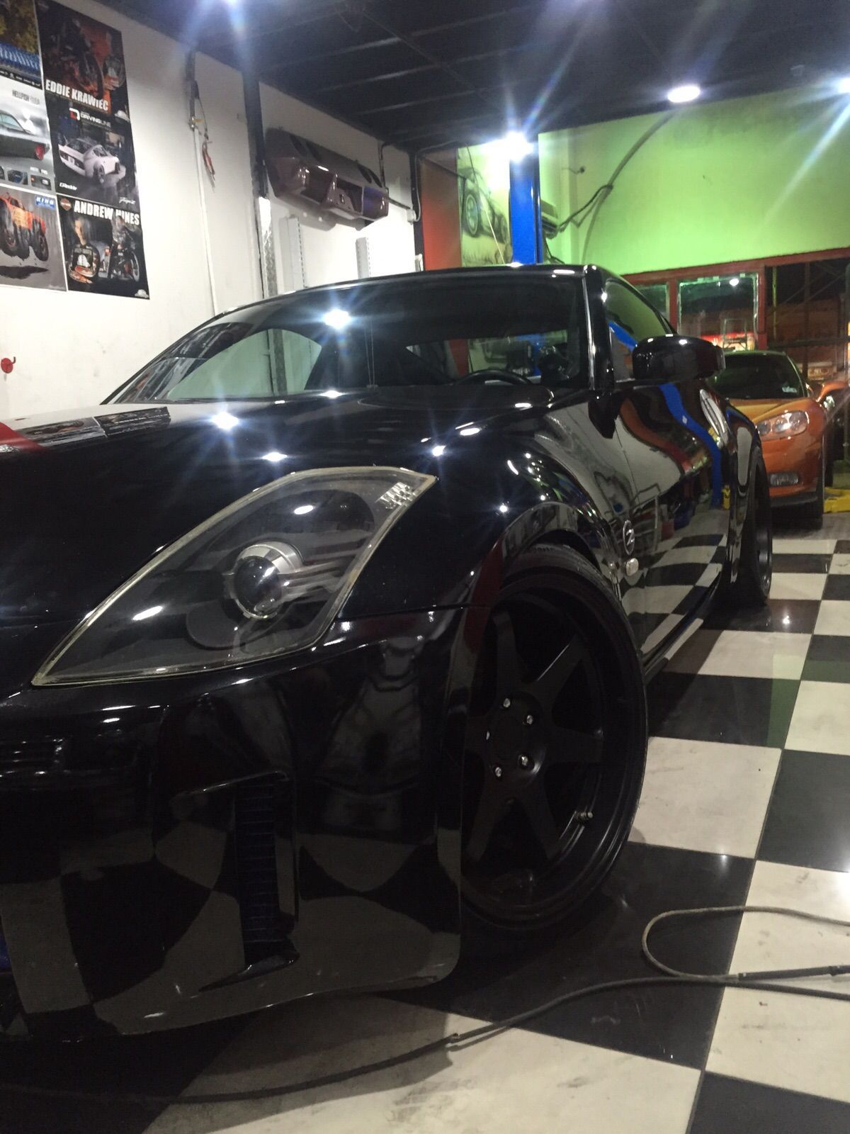

I would like to share with guys my small build :)
Built 2jzgte with CP pistons and Eagle rods,AEM V2, S366 turbo, Titan fuel rail, 272 cams and BC springs, Z33 tranny with Collins adaptor and flywheel, DW300 in tank pump, Oil cooler, Speedhut custom tacho gauge, Mishimoto radiator and fans shroud, Dual Spal rated at 1860 CFM, SouthBend DXD-B 6 Puck Clutch, new oil/water pumps and alternator.

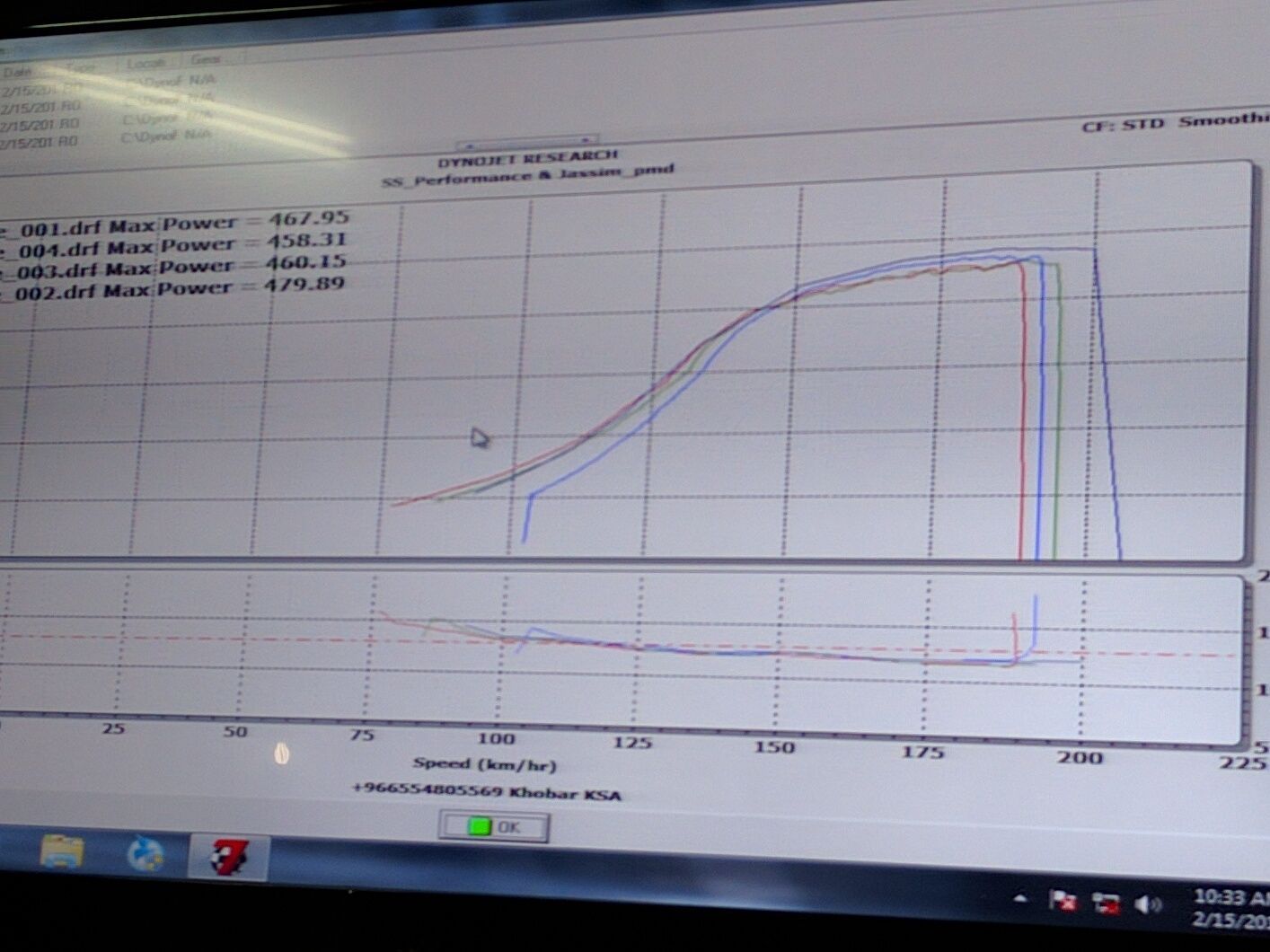

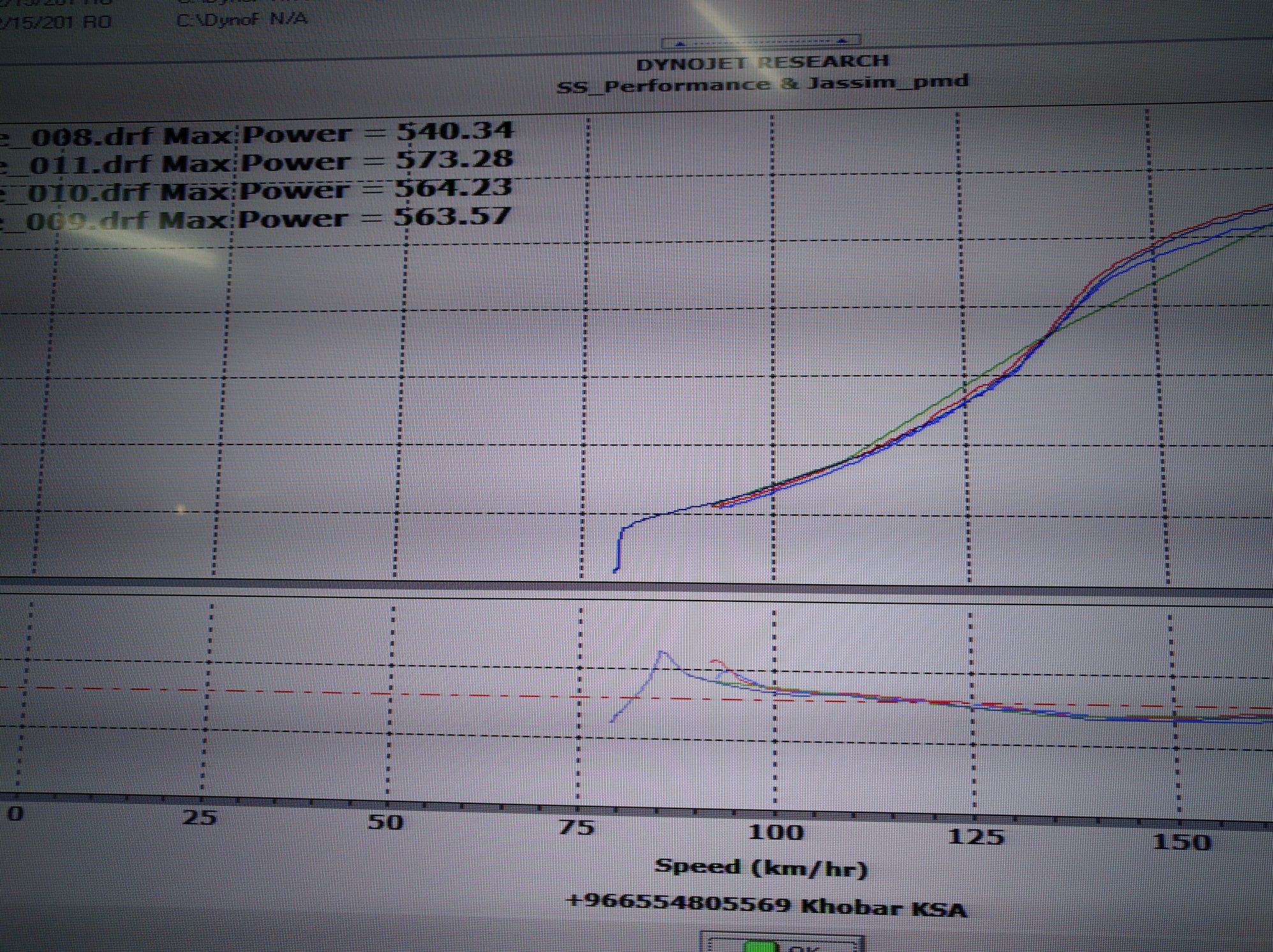

Car made 480whp on spring 14 psi and made 570whp on 21-22psi. Both runs on 91oct.
