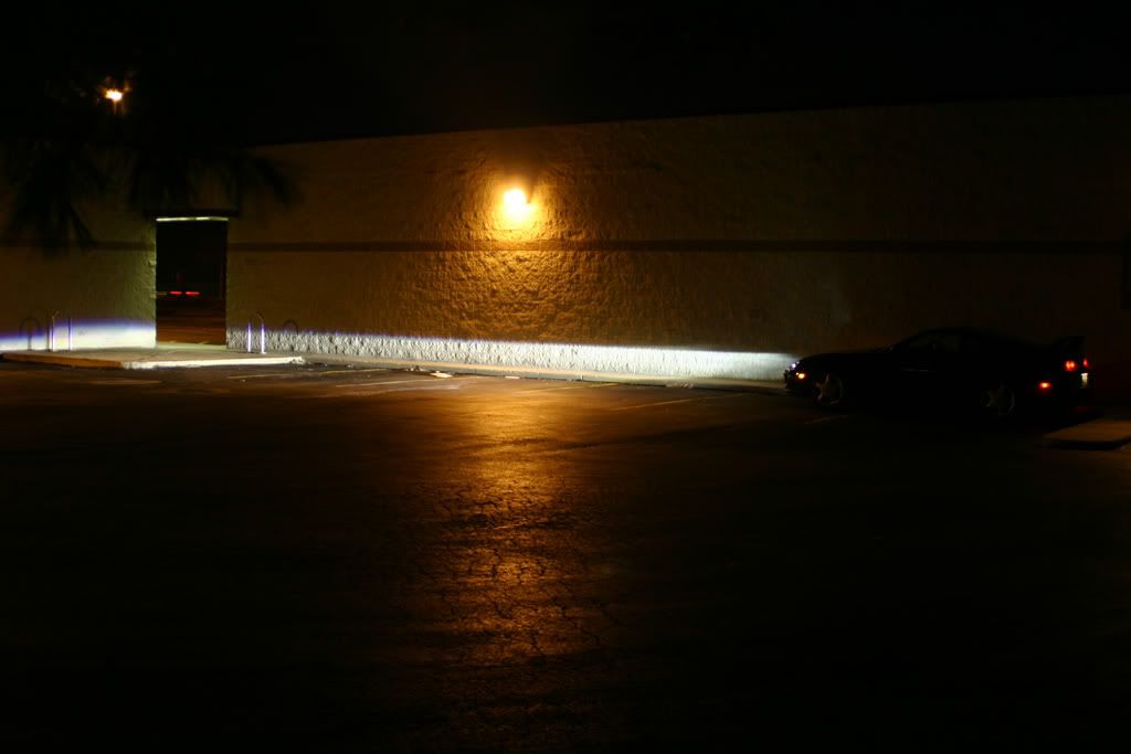

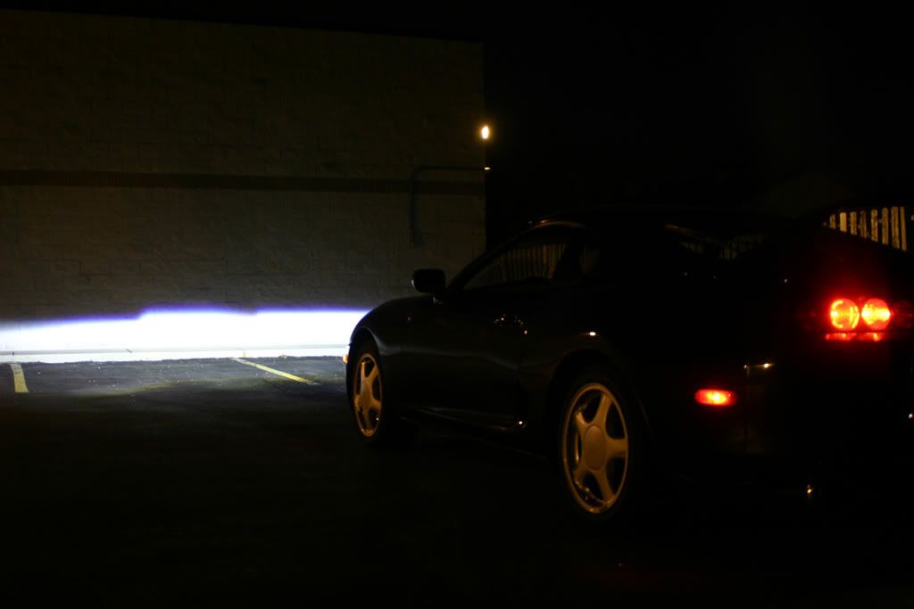

For a few of you that have been asking about my TL setup, here's the update. 1st impressions of this is....damn are these things a pain in the ass to work with. These projectors were very large to start with and the Supra headlight is actually quiet small under the plastic cover. Anyhow after many hours of hacking, cutting, dremmeling, and grinding away I finally have the correct brackets with holes in all the right places and the beam looking nice and straight. I have also modified these projectors a little so that I get more blue/purple color at the cut off as opposed to the bluish/yellowish cutoff of the stock projector. You can see the picture of the cutoff a little below. These are all the colors that you see when a car with HIDs comes towards you. They have not been aimed correctly, but all the signs down my street looked blue...looked pretty cool. Anyway hope you guys enjoy the pics. If you have questions post em here. And for those of you thinking about doing this...get a set of TSX projectors and you'll save yourself a lot of frustration. Much smaller with similar output. Oh yeah the high beams solenoid has not been connected yet, so pics of that will be posted later in the week.

Jesus, WTF. They bright as hell. And the output is straight. Will you considering modifyign them and selling them off to members?

And yes these suckers are very bright =)

How did you modified these projectors to get a little more blue/purple color at the cut off ?
I removed a washer that is inside the projector to move the shield closer to the bulb.
