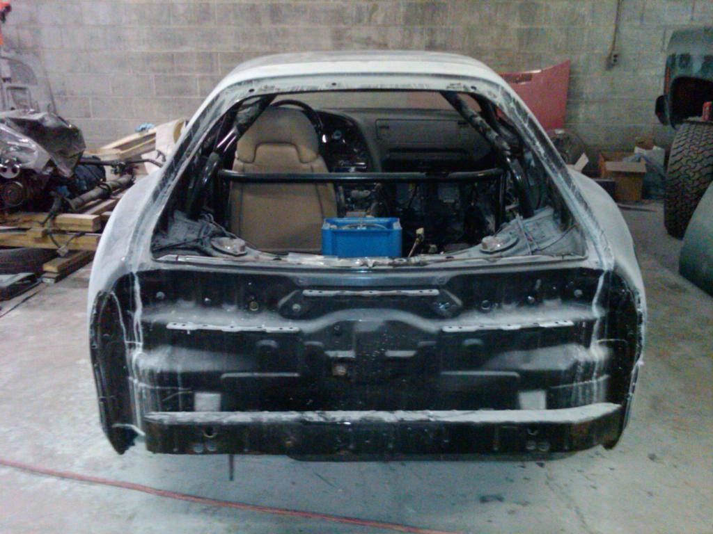

Here is where I started ripping into the car and really starting customizing it. Now, as you will see, this was only part 1 of my build. Many things have changed with the build i have going on now, but you will see that later. I used to live in PA and the following was all done at my buddy Kenton's Show Stopper Customs body shop there. I then moved to NC, where I'm at now, and the car was literally thrown back together the night before I moved! The bodywork consists of a total color change inside and out from stock black to the 50th anniversary lambo color called verde artemis, a custom "wider" body, shaved antenna and emblems, and some custom work to the side skirts. At this time I also redid my calipers, removed the abs, polished every single piece of metal I could in my engine bay, did an engine bay wire tuck, and relocated my battery and fuse box to the rear. I did little misc mods also, but the pics will show those. Its been over 6 years since this part of the build and I don't remember some of "what was done when". I have hundreds of pics, but I'll only post some unless anyone wants to see more. On to the pics...

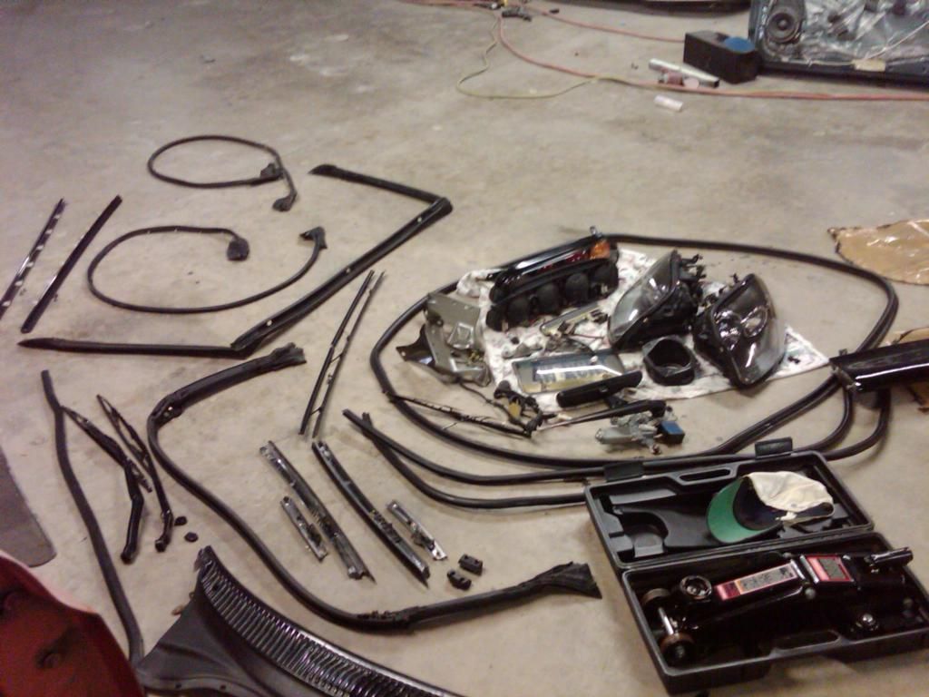

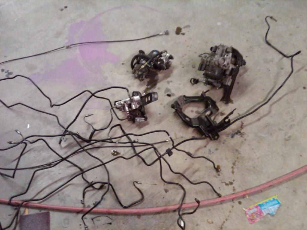

Tearing it apart...

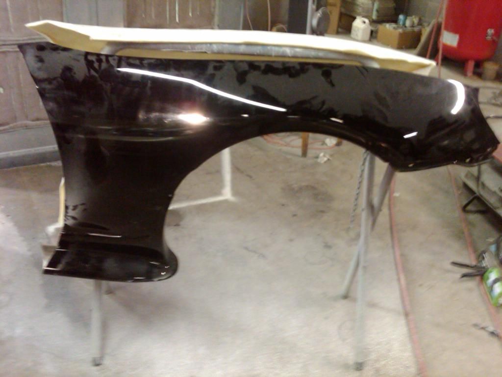

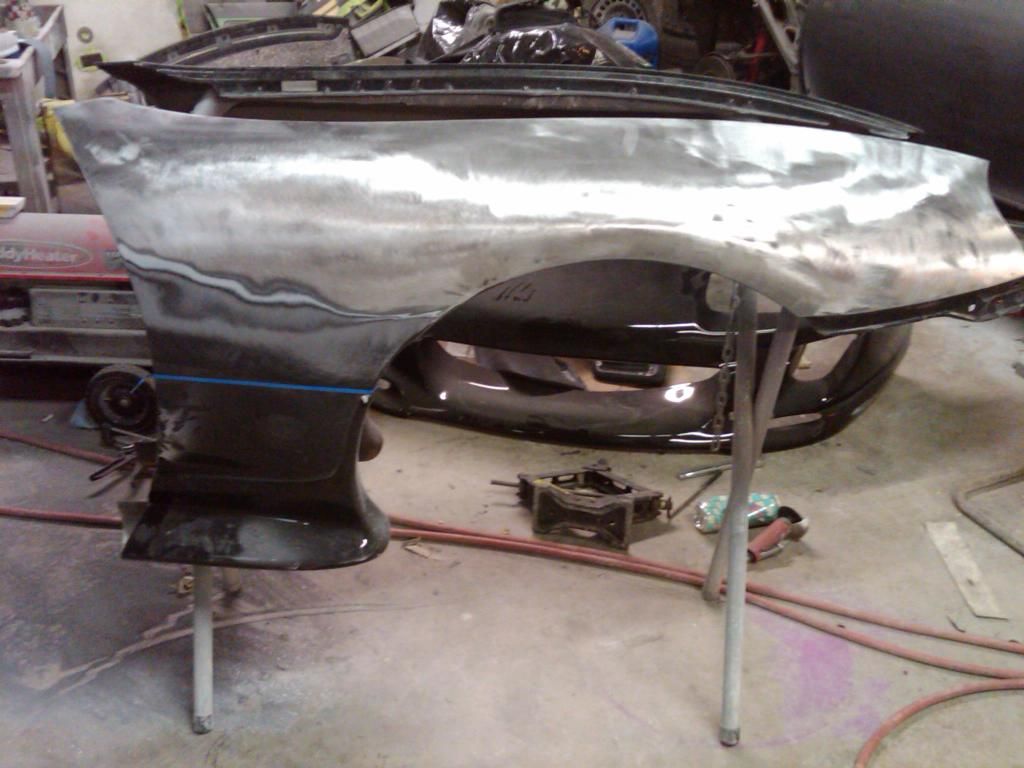

I bought some knockoff (big mistake) widebody duluck style fenders that didn't fit at all and looked terrible. Being that they didn't fit, we cut them apart and used a section of them, molding them to the factory fenders. I also molded the front of the sideskirt to the fender so that the fenders could be removable...

Cut slits in the rears and pulled them slightly, then finished with body work...
Shaved the corners on the stillen front bumper...
