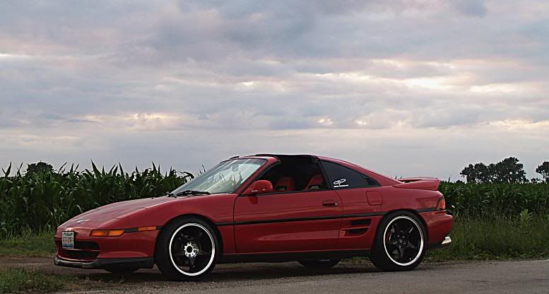

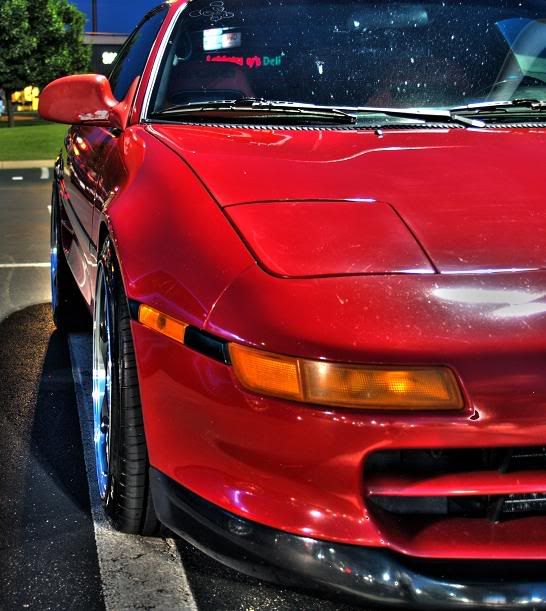

needs more poke!
39 Posts
Discussion Starter · #11 ·
Ummmm, no. Car looks good now. Don't ruin it.
wont be ruined, but will look better. I need to pull my fenders a bit and then I will see if I want a small spacer or not.
Thanks for the comments! Its definatley been a fun car so far.
