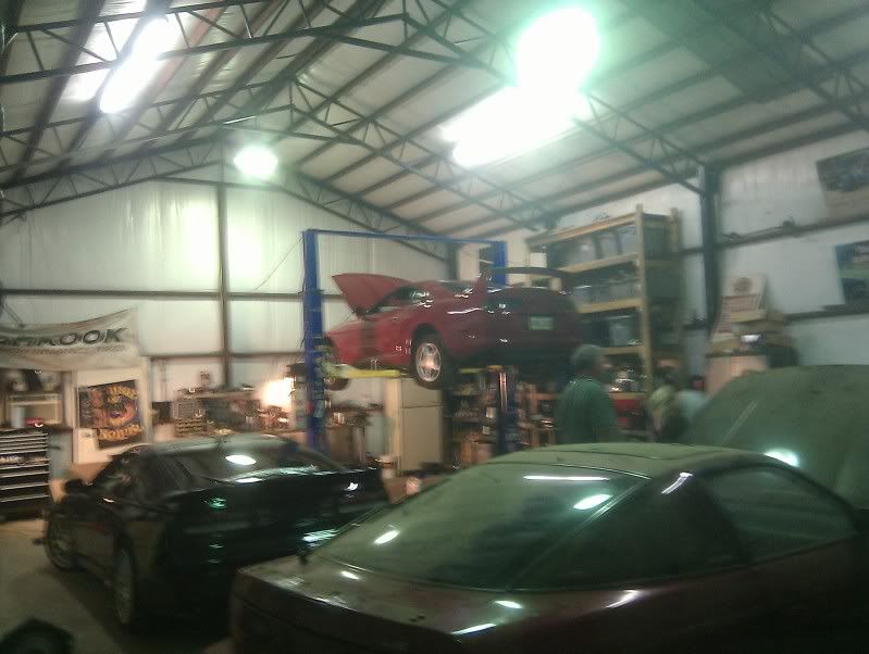

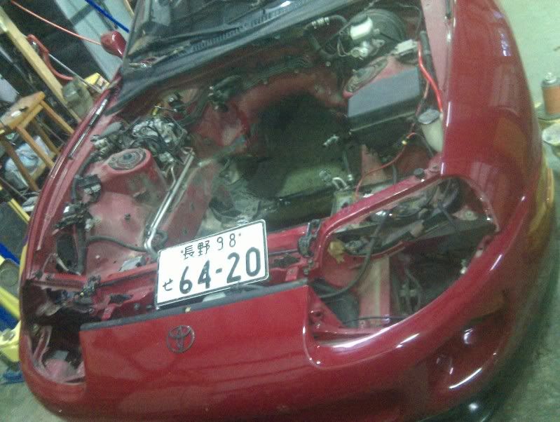

Hey guys I thought id share my build with everyone. We are just about done and I cant wait to get the soup back on the road.
Parts List:
Billet 6265 .86a/r Divided
AEM EMS V1
Divided Manifold
Tial 44mm BOV
46mm HKS style wastegate w/t open dump
XSPower 3row intercooler and piping
RC 550cc injectors
Trans cooler
AEM Serial Data gauge
AEM trans temp gauge
AEM Uego wideband
Had 4" HKS super dragger, traded for 3" Down/midpipe, and godspeed exhaust
PTP turbo blanket
TT headgasket
Dizzy Delete
I probably forgot some stuff. Here's the pics:

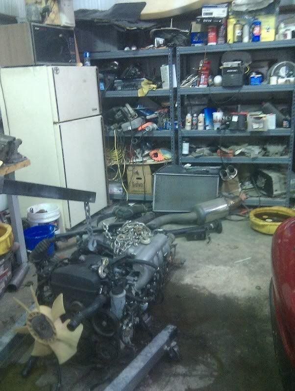

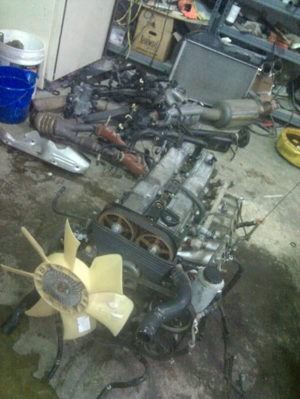

Updated pics of the build. New waterpump/timing belt kit, head asembled, and wastegate mounted. Closer to getting her back on the road!!!
