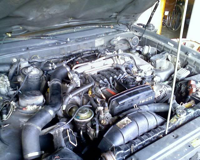

I was going to get some body parts off of it and what do you know.. so i cheacked the coolent to see if it had any oil Nope, i cheacked the turbo to see if it had play Nope (very little, i dont know if it should have any at all), and the oil was good too (really clean) it still has some stuff that really need to get fixed, mostly small parts like the heater hose they cut to get the coolent out at the junk.
BUT!! it wont run without uesing one of those cans to start it.. :crazy:
How would i cheack to see if its the fule pump or anything els?

Turns out that the coil packs are not firing but it sends fuel and injects it in... what the problem is!? lol I hope its just a fuse

Check the ignitor wires......Had a similar problem when I first got mine running.
Drove mre crazy for months with an intermitent engine shutoff that no-one could figure out. Had to have it towed 3 times only to have it restart after techs fumbled around in the engine compartment and touched the wire by accident, thereby thinking they had done something and charging me for nothing. :crossjerk
I was THAT close to selling mine as well........ :sad:
Quick update..Also check your cps wire, similar problem by some other members.

Ill take it apart and reasemble it then.. good idea. Time to get the multi-meter out!!
