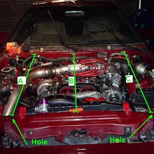

Hey guys, I need a BIG favor from a fellow supra owner. I wrecked my supra a couple months ago:
So I'm currently pulling it back out and need stock measurements of how far to pull the top radiator frame out. Heres the what I need measured:
Measure on the inner edge of the radiator bar by the inner hole for the popup light frame accross the engine to the inner edge of the firewall on both sides A&C. B is the distance from the inner edge of the firwall to the inner edge of the radiator frame in the center.
Thanks
Aaron
357 Posts
A and C I got 37 and a half inches give or take a tiny bit and B I got 36 and a half give or take a tiny bit.
THANK YOU TURKISH
just what I needed, you da man :bigthumb:
