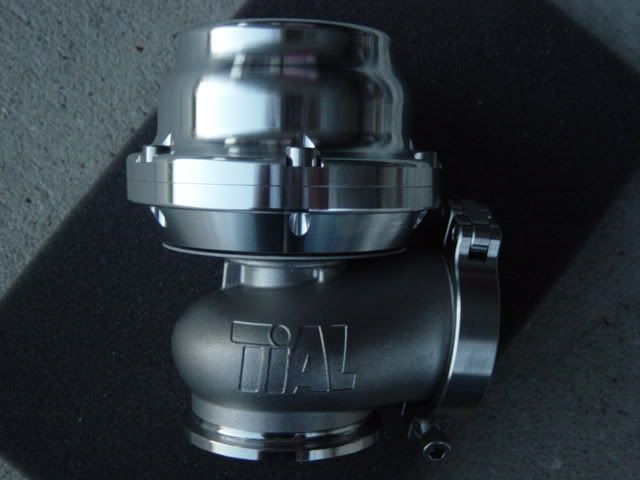

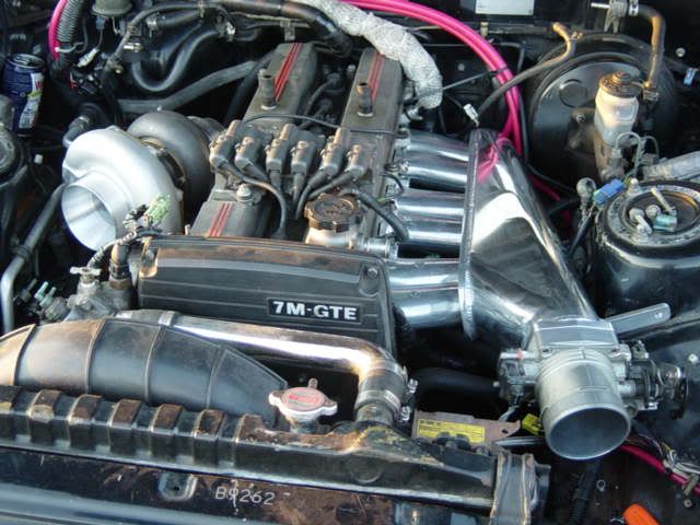

the nice new wastegate

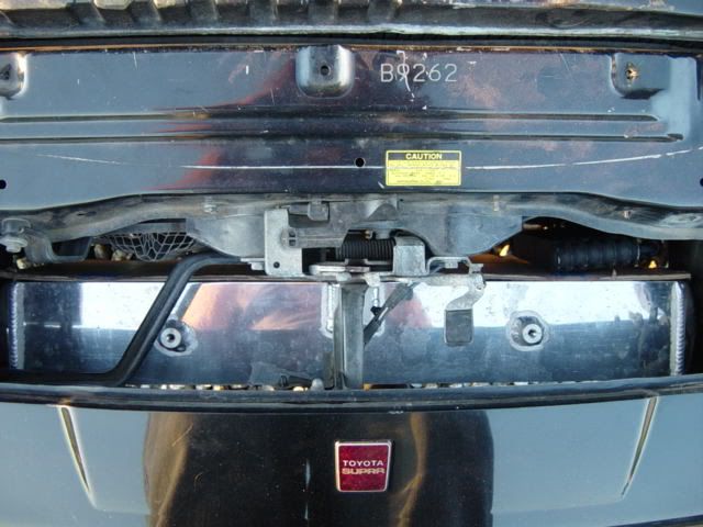

the new hatch with the new battery box
front shot of the new horsepower freaks 3 row

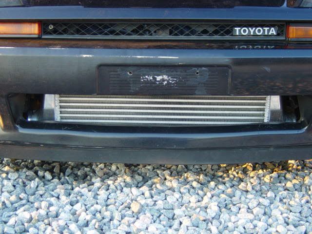

a mkiv intercooler but i made it fit really good :bigthumb:

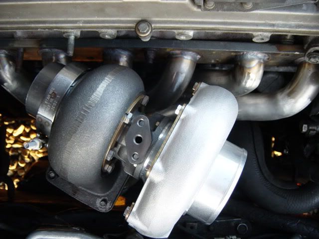

the new SP manifold (and turbo) i am the first one to have the new manifold flanged with the wastegate :bigthumb: :bigthumb:
bay
car over all

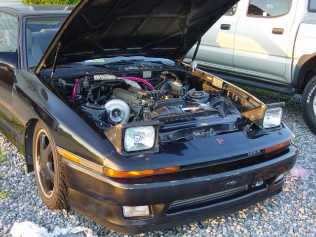

i still need to get AEM and make intercooler pipes and exhaust and a few more odds and ends.....

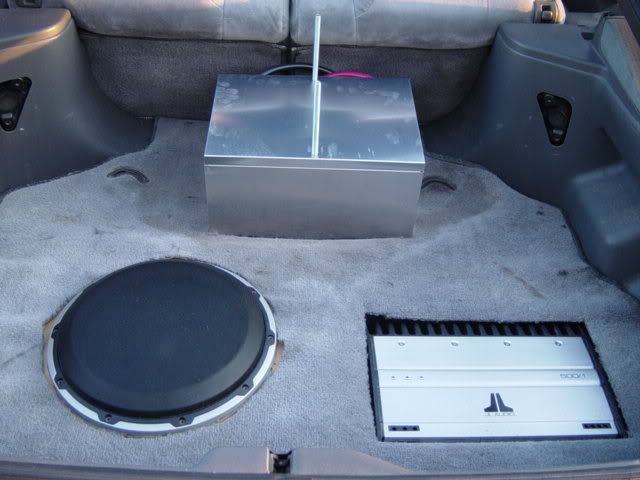

That was some nice car porn right there dude. I like the sp manifold a lot! Everything looks smooth. Do something about the rear carpet tho, it sorta looses the whole clean install you have back there.

nice.. damn that manifold has a kick to it.. makes it a pain for the dp (hopfully it came w/ one though?)

looks good man! how much hp are you shooting for and how long until its released for real?

OMG! No doubt! WAY too much turn on that turbo flange, almost looks like your turbine housing is facing your valve cover... From the pic, I dont see how you're going to get a 3" dp to fit in there... Please let us know how your exhaust turns out... I hope it just looks worse than it is...
What turbo are you running?
Looks good though, no doubt... I just hope that dp doesnt give you too much trouble... :bigthumb:
2,315 Posts
i'm curious if a 4inch exhaust would fit.
i'm about to do my 4inch exhaust setup, but i think i'm leaving my turbo to sit straight (ebay mani) so i don't have to worry about silly bends.
looks top notch
eric
im going to be getting a better cover made for the back its just temp. ill have to change it when i put my cage in
im shooting to get 700 rwhp out of it all i have to do is add another pump in the tank and let her rip...
thanks guys for all the good feedback, i know the exhaust looks tight but i sure i get it in there ........o and its going to be a 3.5 exhaust not 3 :bigthumb: and far as the turbo it a SP 67 with a .96 A/R
The RPS manifold I had and that several others have had put the turbo in the exact same situation and a 3" fits in there no problem. I could have gotten a 3.5" on there, but with goals of 500rwhp, it wouldn't have been necessary. It just takes a little extra work. Of course the RPS mani came with the section of about 2 feet of pipe that made the curve for you. Big plus on that :)
SP67 w/ a .96 A/R ? Are you revving to 10k or somethin? That will take forever to spool!
looks top notch
Good luck.
it would actually be easier to have the turbo on a slight angle to fit a 4" downpipe with the ebay mani.
3" just BARELY clears the firewall, it will take some very tight radius bend to clear a 4" pipe there.

SP67 w/ a .96 A/R ? Are you revving to 10k or somethin? That will take forever to spool![/QUOTE]
i what to move the rev to like 7500 with aem and then after head work like 9000....

About how much did the SP manifold run you? I see your running a Sethron manifold too ;)
Awsome set up! What turbo is that your running? The SP kit complete?

Exhaust manifold Matt, I have the same intake manifold.
