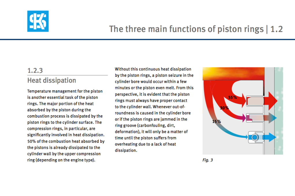

Approximately 80% all of the excess heat created during combustion is absorbed by the piston. Almost all this heat is transferred through the piston rings. By allowing oil to flow near the crown it substantially lowers the temp. By how much? Depends on the boost you are running but this is a good estimation.

@ twinturbosupra94 the more boost you run and further past stock level you go the more important cooling is. You don't want the piston to end up like this.
The oil will actually turn to carbon on the piston itself.
