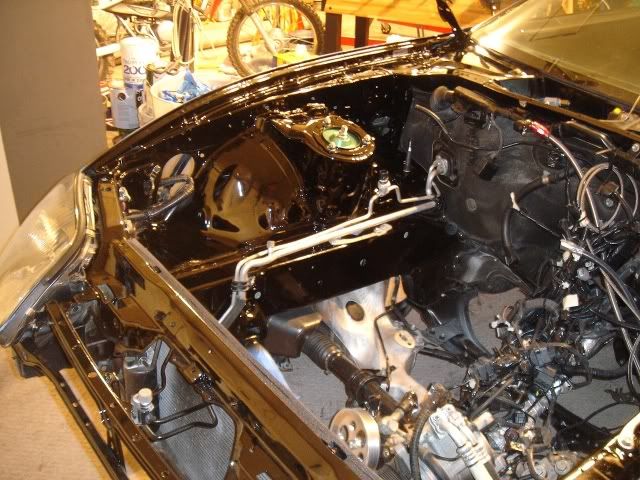

Well I am glad I got it done! The motor was out anyway, I wanted to rip out the ABS system since I hadn't had a fuse in that anyway for years. Had to remove all the brake lines while pulling ABS, so I figured this is about as cleaned out as she's gonna get. I had Lots of scratches from all the times I pulle the turbos or changed turbos. The difference now that its painted is huge.
BEFORE:
AFTER:

For me it didnt really take much of either. I mean the motor was already out, I was planning and taking everything brake related off the car anyway so really didn't take extra time. Didn't cost much to do it either. Most body shops will do it for the price of a hood repaint. Well worth it!
[ Motor can be out in one night, then you have to collect all the wires towards the center so they can be easily masked over by the body shop. I took the time to cover each individual connector so nothing got into the electrical while it was away from home being painted. I also zip tied everything up religiously so that none of my wires would fall down through and get snagged. wasn't going to mess with the AC lines and recharging. I was able to get enough slack in the main fuse box wire to lift it up and out during the paint. The smaller fuse box on passenger side was simply shoved out into fender and zip tied in hiding. All the aftermarket gauge wires had to be passed back through the fenders as well so that they were out of the way. Wasn't a ton of work, two evening maybe ]

We used a compressor with heavy duty paint gun. Using good olde Toyota black # 202 :)
Motor was out getting a new stroker kit for the bottom end and the head was shipped out for a full port and polish job using Ferrea parts ( 1mm+ oversized valves ).

To remove the ABS system it will require you to run all new lines throughout the engine bay.
I can get you part numbers for all this stuff when your ready. Basically you are going to run a line out of master cyl to a splitter and then connect that line to the two rear unions or connectors that then connect to the oem rear lines. Then you run a new line for the front brakes which will also need to be split into two. Curt at Elmheast Toyota helped me find the splitters I needed. You can probably use the factory clips on the fire wall to anchor the line that goes across. For other areas you will need to buy aftermarket anchors to hold the new lines in place. Once you get it all installed, then comes the time to bleed the system, which can be a tons of fun unless you have something like a "mighty Vac" bleed system.
Hit me up when your ready if you need any help with it.
