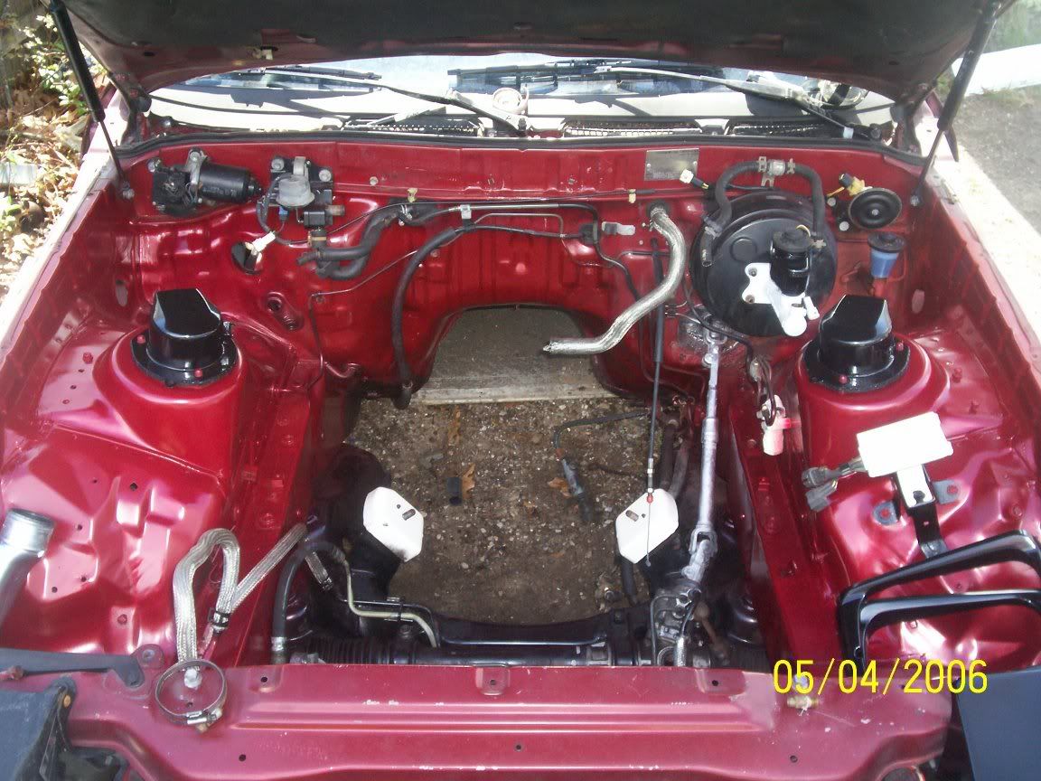

Fresly painted engine bay
IC mounted

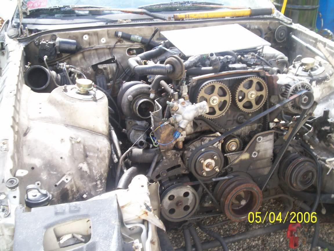

GTE thats being swapped into the n/a

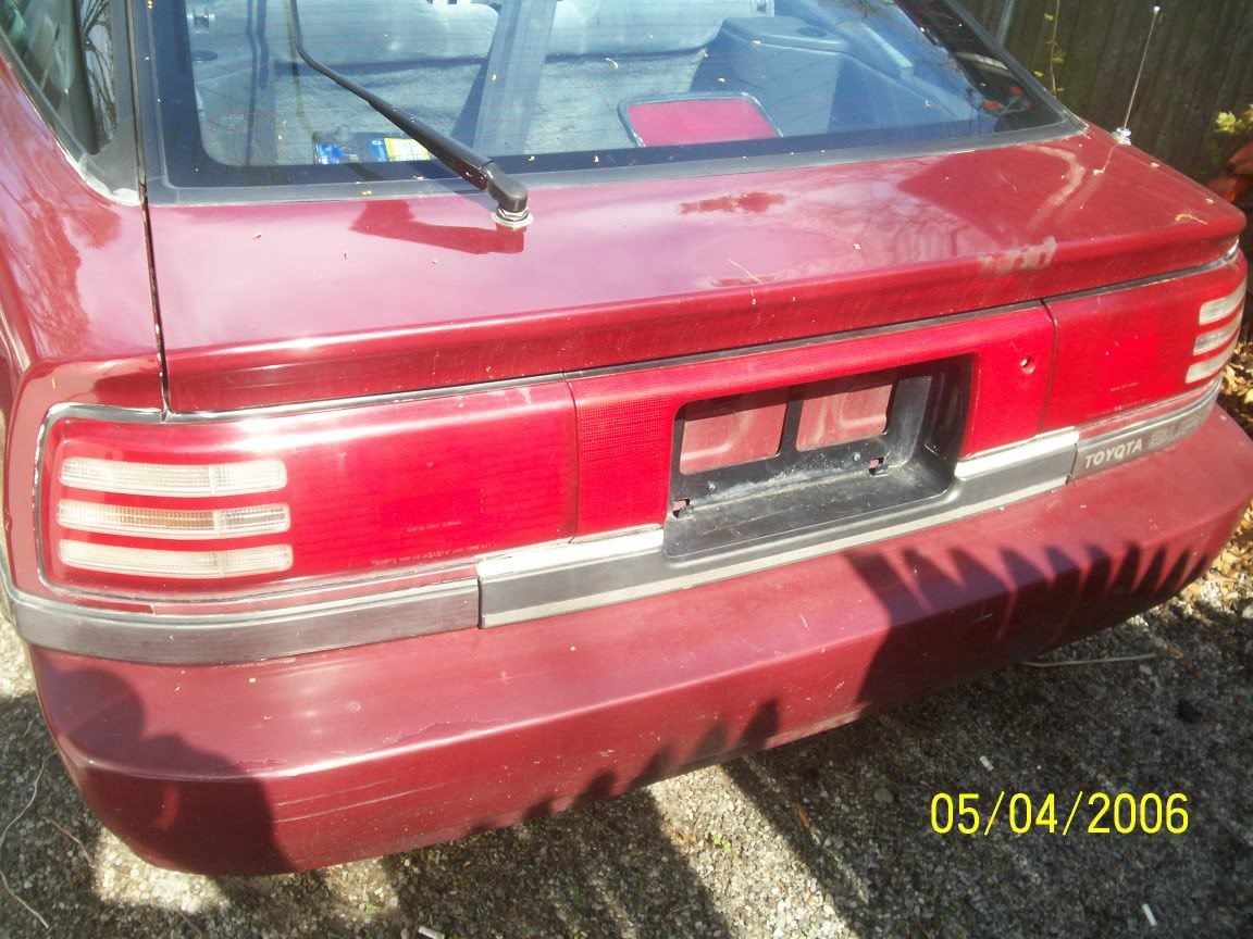

freshh 89 3 peice taillights on the 87
still have to touch up the motor and put new HG and turbo...ill post more pics when i go back to workin on it...

If this wasnt a project, idk what is......swapping harness's...87 to 89t. damn. first time btw...
357 Posts
What harness are you changing? You don't need to do all that to change the engine harness, you changing ALL the wiring? What a pita lol. Goodluck with everything, looking good.

yeah i hadda change the harness cuz the plugs were different on the computer and my car didnt come with turbo or abs so....yeah i hadda change it....plus its only the harness from the dash to the headlights....not all the way back (thank god)
3,123 Posts
Pretty sure all you needed was the engine harness, not the body harness.

Ya =/ all you had to do was pull out the glove box...

yeah i tried to juss swap engine harnesses but the harness from the 89 had different plugs by the ecu, plus i wanted the abs and stock turbo boost guage....ohh and the speedometer needle was messed up in my n/a cluster....

DONT do the abs... our system is archaic and youll be happier without it...
where does that guy in mastic live?!?! i never seen one out here....well...once in the summer for 2 min...haha...
A GTE engine harness has the ABS, and all the extra turbo wirring. Just needed to get a matching harness/ecu depending on the year of either the harness/ecu. Body harnesses are the same for the most part and would not effect any of the stuff you mentioned. :) Speedo-cable is also seperate of the body and engine harness.
