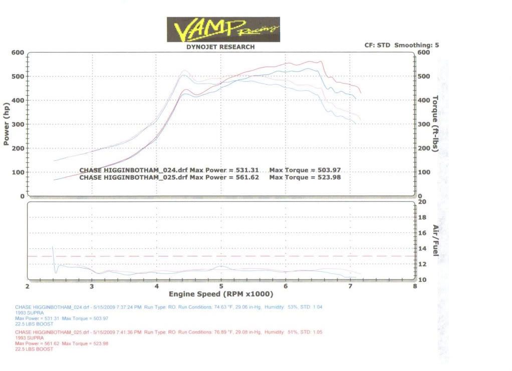

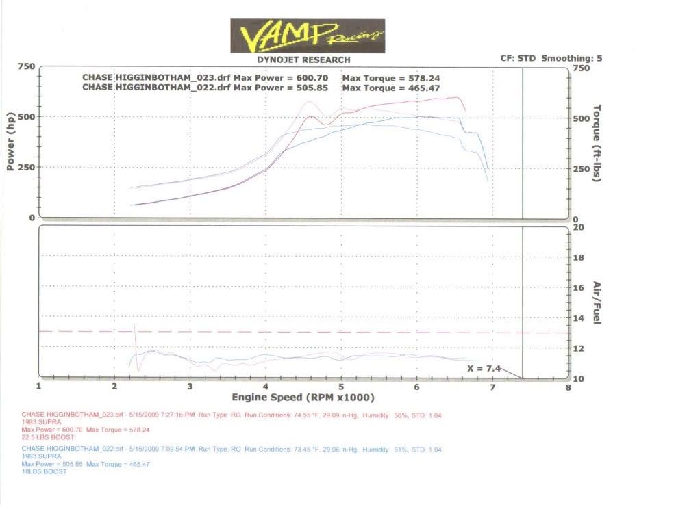

Here is the first dyno pull, boost controller was turned off, boost was wavering between 17-19lbs. The overlay we turned on the bc, all race gas... its spiked to 1.7bar and then fell down to ~22psi.

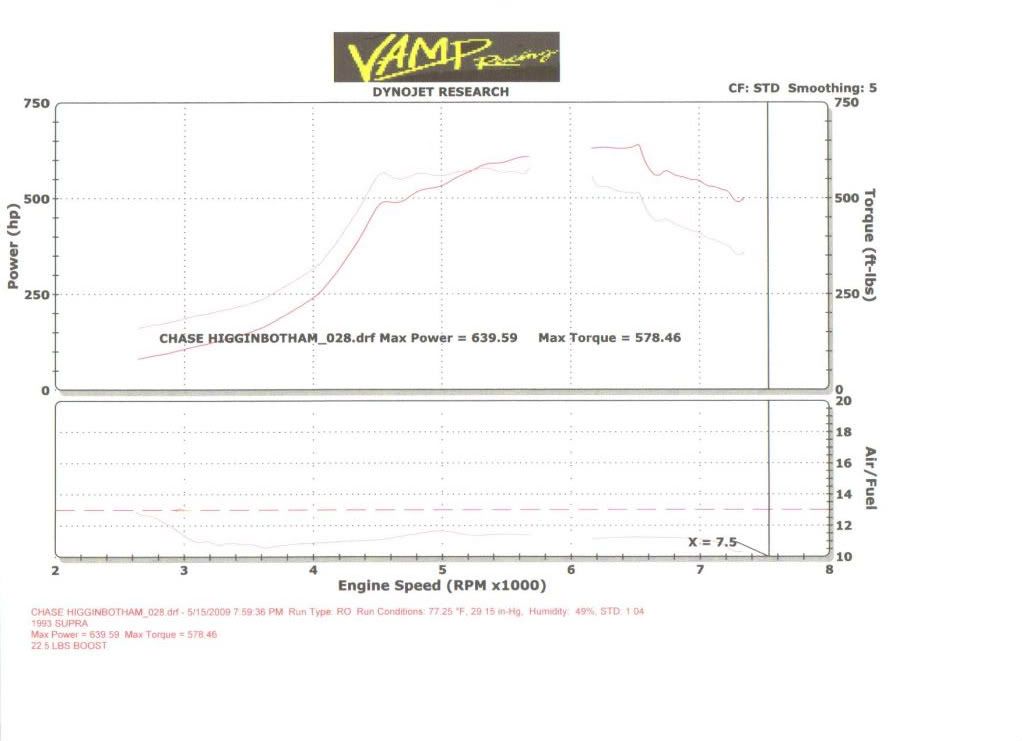

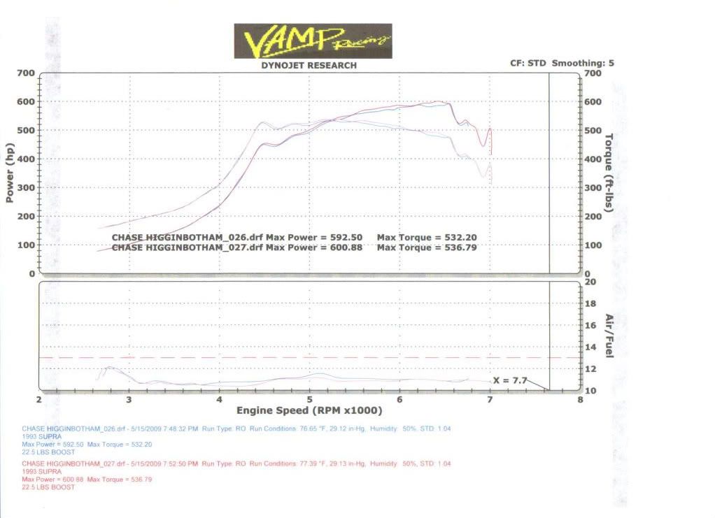

We turned the boost up to 25psi and started tinkering with the bc to get it to hold. The turbo is really wanting to spool up and was spiking a little but we got it ironed out. Here are several charts and videos.

We were at the limit of the race fuel I had. 110 octane. The best results was the last run of 639hp 578tq. I would love to turn it up to 30psi or 32psi and see what would happen I just want to mix in C16 or Q16 at that moment. We were also only revving to 7200, the motor can turn 8k easily but the turbo wasnt making more power at the higher rpm's so we didnt see the point.

You've got something going on at 6500rpm. Either valve float or some form of cut. Get that checked out and the power will be extended by quite a bit.

The car definitely put down some nice numbers no doubt. Those first dyno pulls were where we were letting off a little early, but they still show good base numbers for the boost levels. :) It will be very interesting what cams do to that combination!
Let me know when you are ready to have me finish the tune with C16 and 30lbs of boost and then we are really going to see even better numbers not only because of boost, but because of timing as well. :) Remember I only put around 12-13degrees or so of timing in the car where it was making power, so you defnitely have more to go there when we use C16 in the car. I just wanted to keep it really safe for you and even being safe the setup still makes good power, but I know the timing will wake it up more and when we get better gas in the car we will turn it up a bit. :)
The AEM was showing a nice flat 11.2:1 AFR all the way through the run only varying by maybe .1 or so...that should be very safe as well. Let me know if you want the log of that final run and I will shoot it over to you.
If you ever decide to do cams on the car you will make a lot more power no doubt...you can see by the top end that this setup does not like stock cams so much. :)
