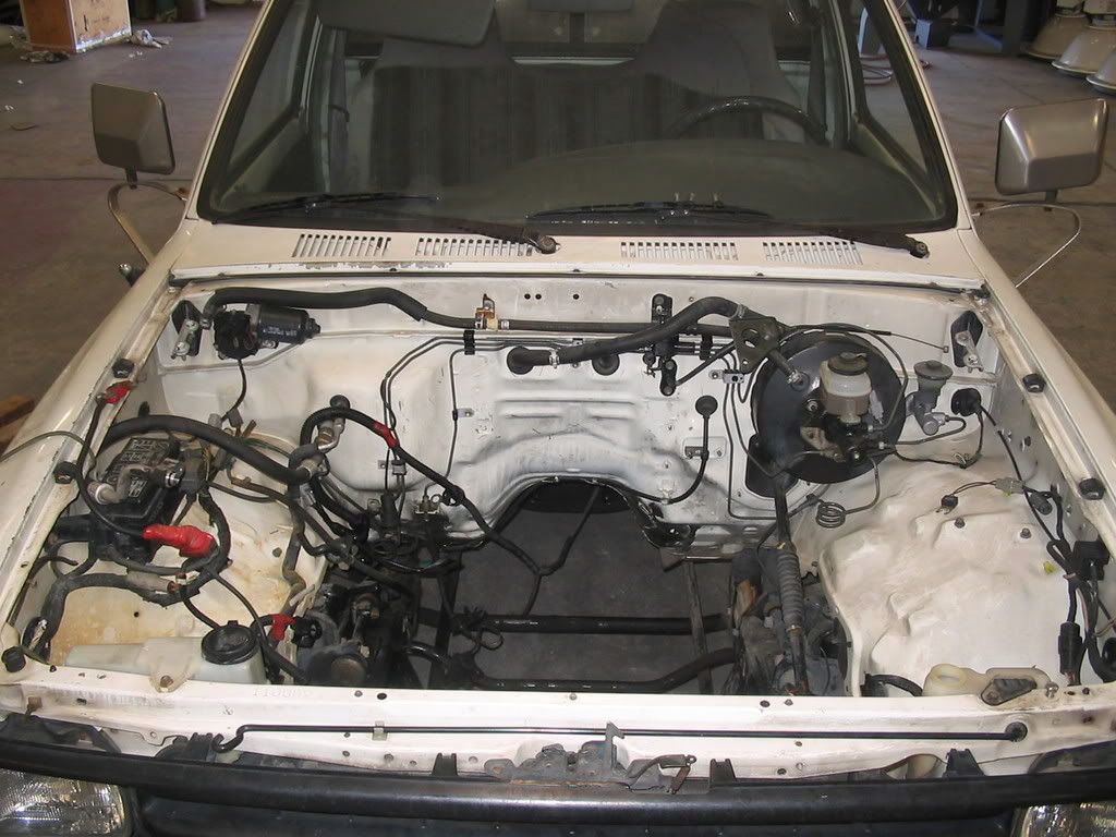

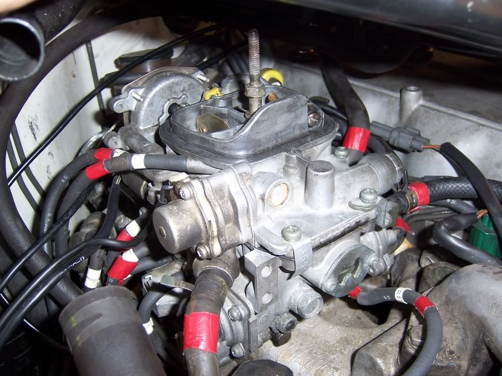

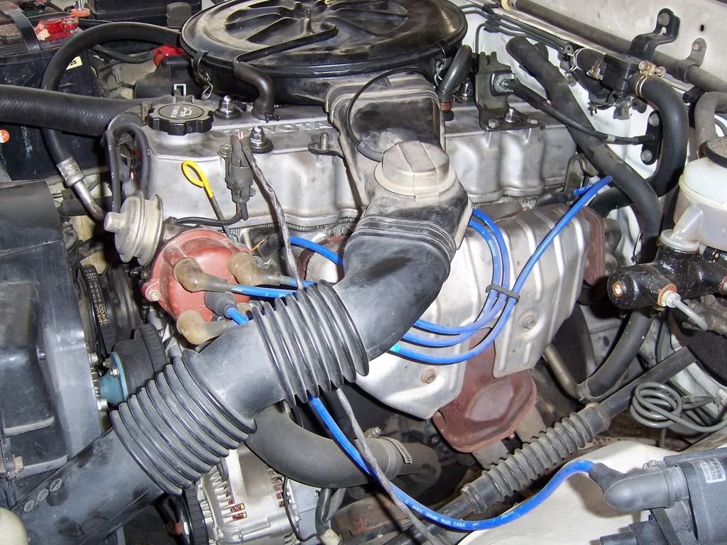

here are some engine bay shots before motor was pulled.
Here is the truck with no engine in it. got the motor last monday and put on timing and acc. belt, Denso spark plugs, re-sealed the water pump ( jdm couldnt find one in the US) also installed a new auto tensioner and front oil seal.

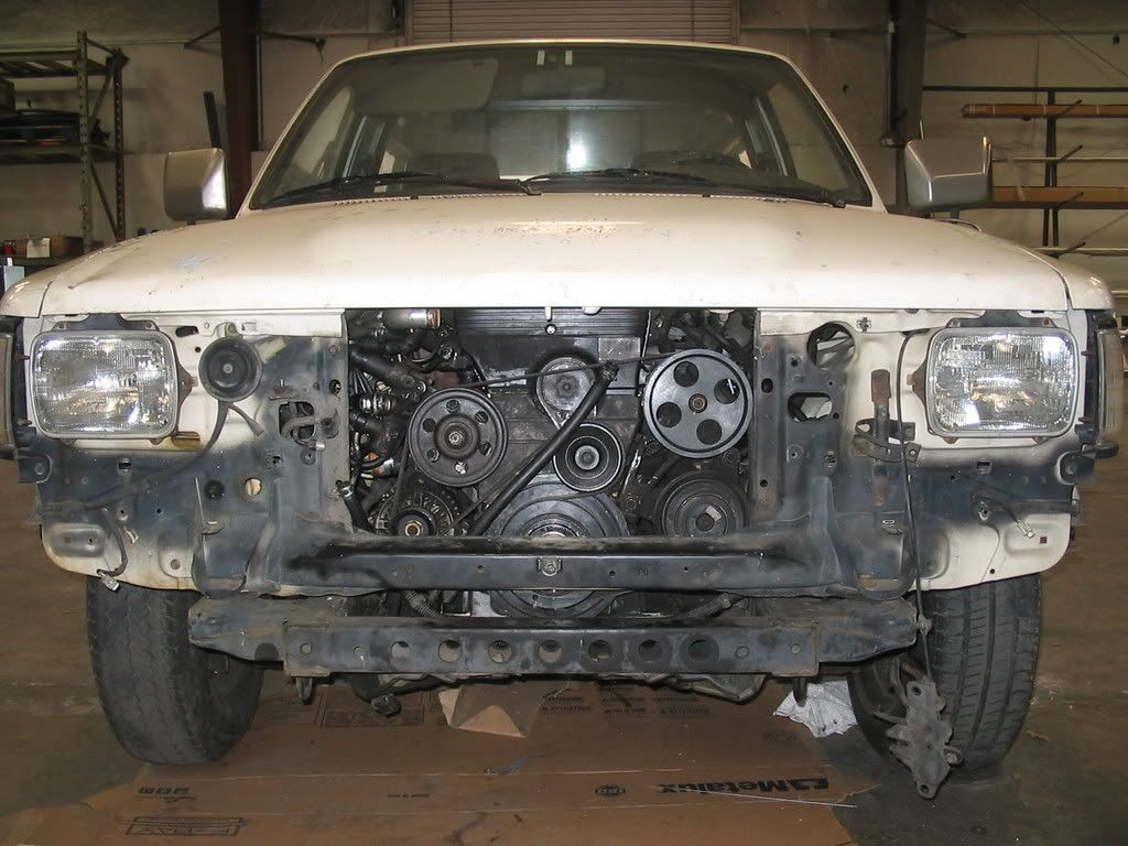

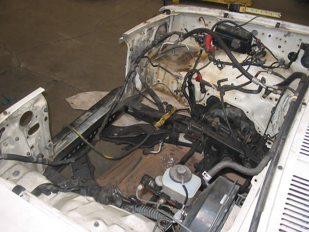

heres the engine bay empty and waiting for the 2jz. just geting it all prepped, moving lines and cables out of the way that might get hit. Look at those mirrors HAHA, total sleeper.
Had to take off the grill, bumper, and the A/C (for now). also chop the bar to just get the engine in there. gonna make a bracket so i can have that piece still in use and be removable so the motor can be pulled out easy. that piece being moved made all the difference.

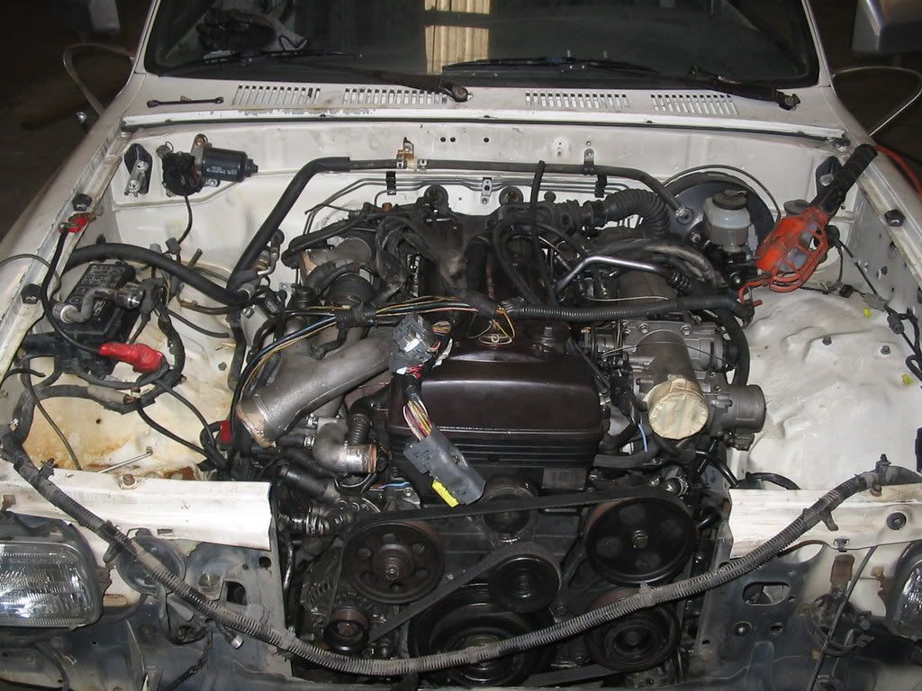

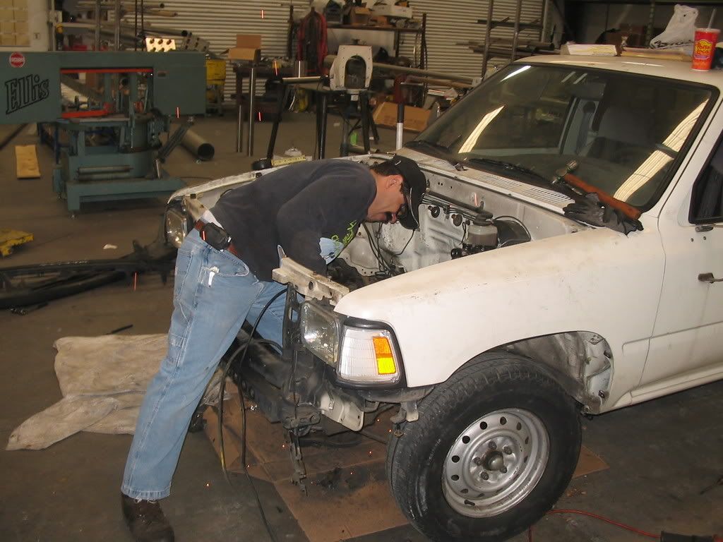

(Without my friend George this wouldn't have been possible.) George grinding some of the engine mount making for a clean area to weld.
2jz in and mounted

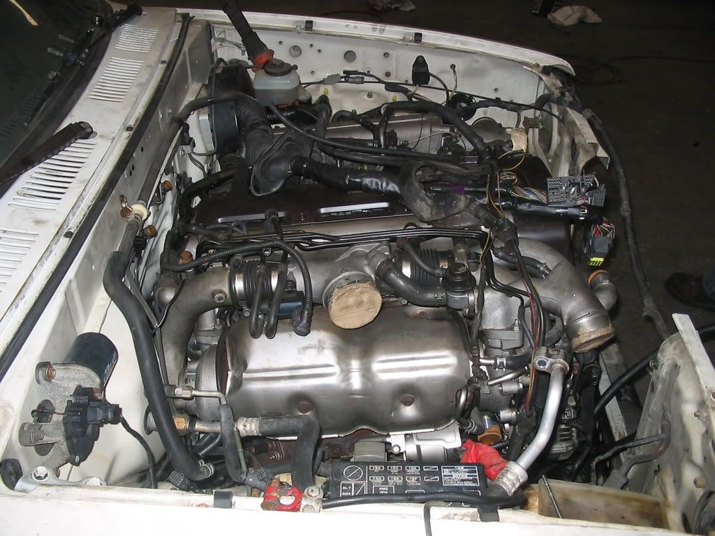

Side shot. that U shape in the turbo inlet stuck out a lot making it time consuming. but it worked out
The hood clears. no rubbing anywhere!
