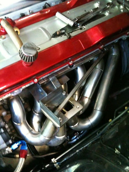

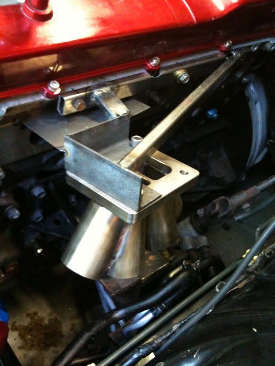

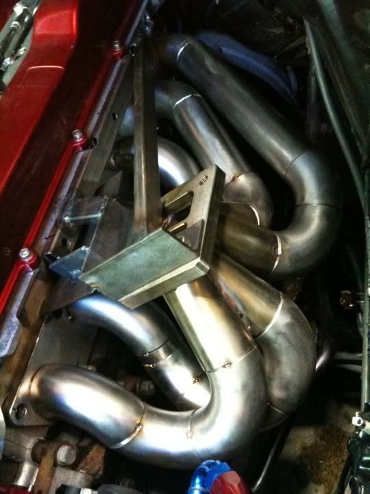

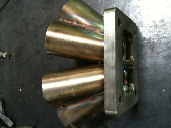

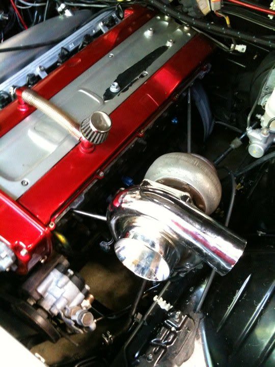

I've had this car for a few years and ran it for about a year with the E-Bay manifold and a Holset turbo. I did a lot of research into the aftermarket manifolds like 6-Boost, Full Race, LoveFab, and others and I decided that we could make our own. A friend owns a shop and we decided that we'd give it a shot. We're making a kig off of my manifold so we will be able to make more if anyone is interested once mine is finished and tested. So far I am very impressed with the outcome and am excited to see the end product and it's performance. Check out some pics of our progress so far......

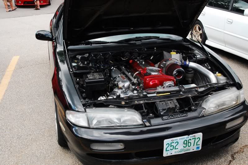

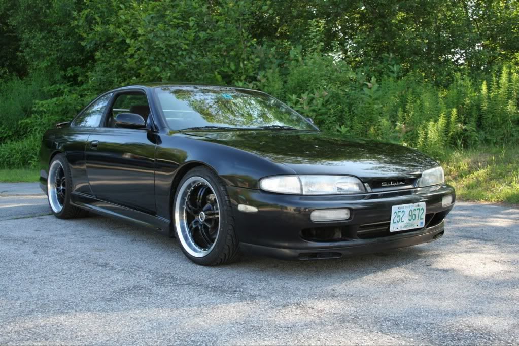

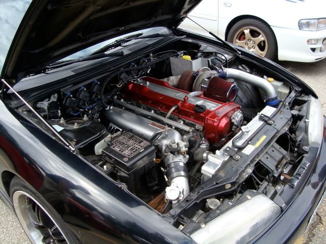

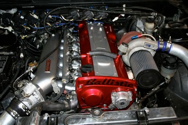

Some pics of the car and set up before the new manifold.

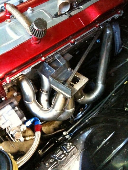

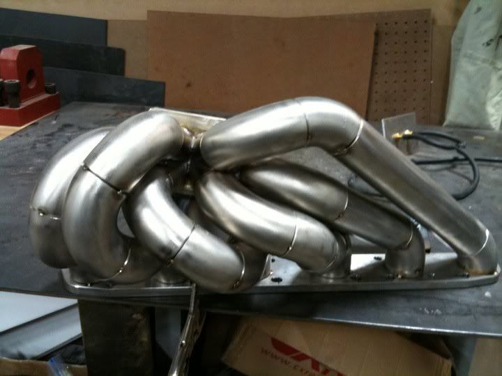

New pic, all welded up.........
New updates:
Starting to put the final touches on, new one piece I/C pipes powder coated and new DP.
Car is done and running, we did a very conservative street tune at 15psi and this thing is an animal!! The sound is amazing, the fitment is perfect, and I couldn't be happier with the quality. It will hopefully see dyno time in the next week or so. My tuner is out of town and I just don't trust myself to do it so we will have to wait. Here's a few more pics, I'll try and get some better ones when I have time and it's nice out.
