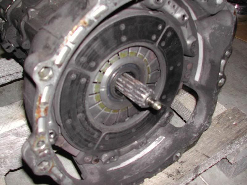

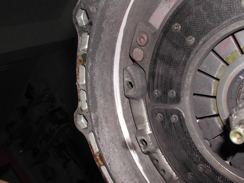

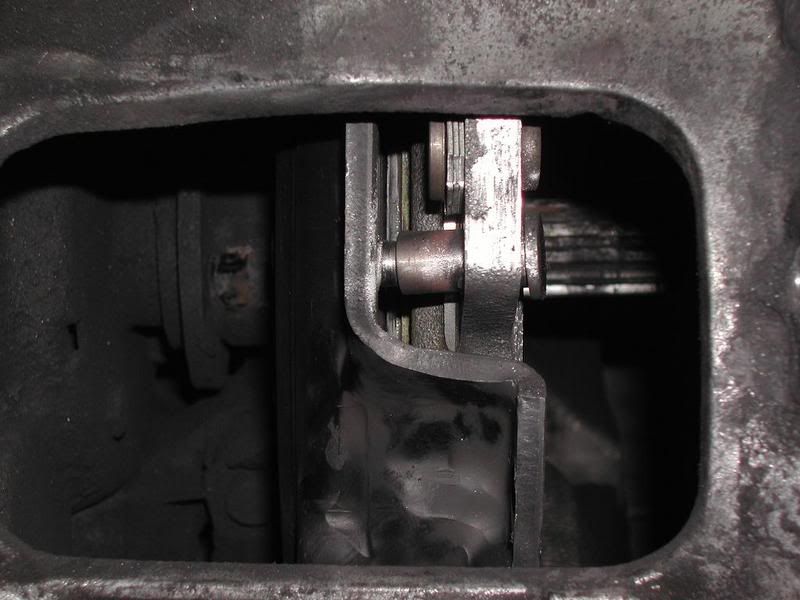

RPS C/C with ~1500 miles on it. 1 trip to the drag strip with 3 passes. The clutch was flawless, then one day I got a bad vibration. See pics...
What would cause the clutch to touch down and grind the inside of the bell housing?
These pins aren't supposed to come apart like this pic are they?
since the clutch lasted over a thousand miles with no issue I can rule out install error. Is this a product defect? I'm not anywhere near the 900 ft lbs to the rear tire.
UPDATE on page 5...

This happened to a SF member "sadil" aslo!
Same exact problem.
Pins start to tear away from the pressure plate and start to move diagonally.
Pressure plate doesn't release evenly and eventually the leaf springs near the pins TEAR apart and trash the bellhousing and of course become unbalanced.

Sorry to hear that James. Yeah that happened to me on dyno. My clutch has about 10 passes and 2k miles. When I send the clutch to RPS, Rob called me and told me that the reason these clutch fails is because of not doing the burn out properly. While doing the burn out you should not suppose to let the gas go (this is not how I do burnout but still my clutch failed). Increasing and decreasing the rpm during burn out put a negative pressure on these pins and they are not designed for it.
With shipping and brand new pressure plate cover you are looking at $230.

Looks like a definite PP failure. Let me know the feed back you get from RPS. I've always heard good things from them. My C/C does not fully disengauge during high rpm loaded shifts. I'm wondering if mine is starting to do the same as yours since I believe the plate is not releasing straight.

This happend to , two of my RPS Stage 3 clutches. The pins/straps in the pressure plate broke.
We found out later that is was the Lightened Fidanza flywheel that destroyed them.
Since then i put the stock flywheel back in and have no problems
here are pics of one of the Pressure plates. This one went like this after only 1000 miles. And in the other one , the straps in one place broke totally off. Damn Fidanza Flywheel
