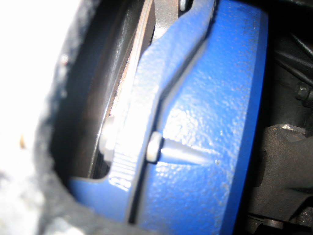

Well, as near as I can tell I managed to kill a spec stage 3 in under 20k. The flywheel was resurfaced, and I followed normal break in procedures. Further more, aside from a few burnouts and a dozen hard launches the car had mainly just been a driver!
The pics are not great, but it doesn't look like there is much material left on the pads. Further more the clutch is chattering a lot! And has very weird pedal feel.
What do you guys think? Did I do something wrong? And what clutches have you had better luck with in terms of mileage

is the clutch disk a solid hub or a sprung hub?? (a solid hub will not last long on daily driving use). anywayz, as long as the clutch doent slip then it should be OK. and I think that the stage 3's is not that very well for daily driving. also, the type of clutch disk (carbon/kevlar or carbon/carbon) would make it chatter.

my spec 3 when i replaced my motor i was worried about how much was left on the pucks....didnt seem like a whole lot at all!! but yet its holding up find after about 22k miles with boost all the time and burnouts and launches everywhere i drive. hasnt gave me a problem yet...but i am worried about its life.

My concern about the chatter is that is there was no chatter last week, then all of a sudden it got really bad!

I'll see if I can take a pic of my disk. I haven't used it yet so it may give you an idea about the life left on your disk.

It is interesting that you guys keep bringing this up... I have also had a weird whining noise from the tranny, which also could be that bearing... either way, I guess the motor is getting pulled, and the clutch replaced!
