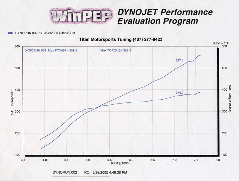

Thanks to Darin for getting a nice base tune on the AEM and to Nero for the hook-up on the dyno. Car is still pretty fresh and there are a few bugs to be worked out prior to getting some good miles on it.
Pull was made at 11psi on 93 octane, on this pull the boost creeped to 15psi up top which is why the graph doesn't have a downturn. Needless to say I am super happy with the results and can't wait to get some C16 in the tank and turn the boost up, we managed a pull where it stayed at 11psi and the car made a conservative 539hp.

Wes glad to see the car is up and running.. so that proves the Ebay manifold works.. nice job! See you sunday @ moroso.

Congrats on the numbers Wes, its some good numbers :) Now bring the boost(just make sure to run race gas or if u run meth to fill it up :p)

Wait...you made 539rwhp at only 11psi?! WoW...didn't think the PT40-67 was big enough to do that....

This car is going to live on C16 ones it's ready.
I was suprised with the numbers as well. The car does have quite a few things that help (264 cams / Virtual Works Intake / 4 Row Intercooler / Tilton). All in all I am very happy with the numbers, we ran a T88 car shortly after mine was off the dyno and at 14 PSI on a VPC it made 540.

^^^ Thats good but knowing Darin he may not want to turn it up pass 30psi with the stock valves and/or rods and pistons... hopefully you will have better luck convincing him to go pass 30psi
