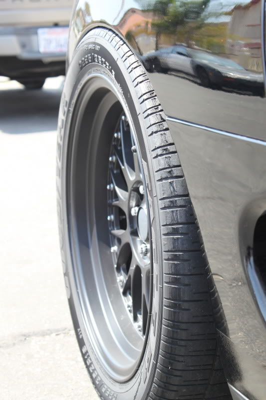

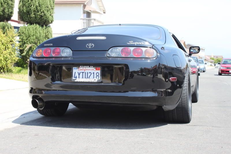

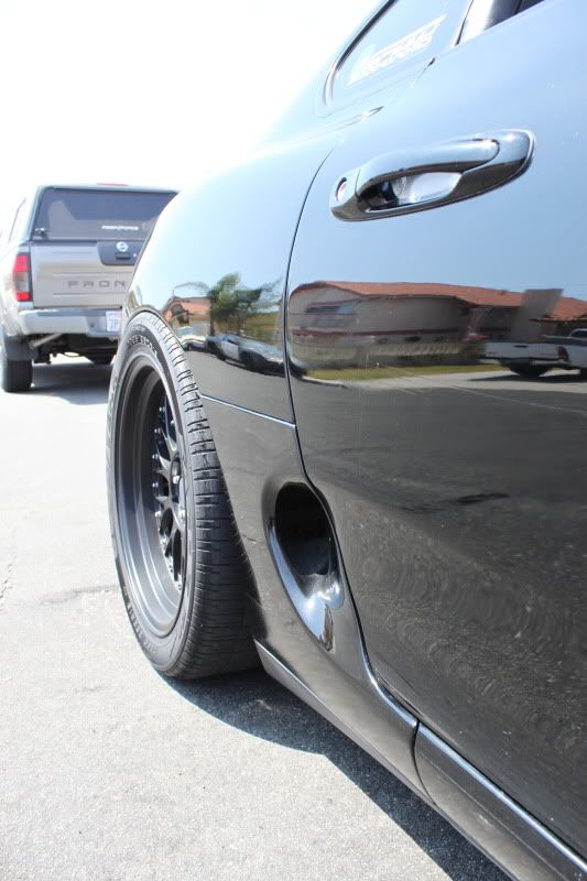

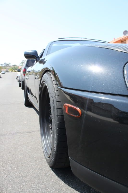

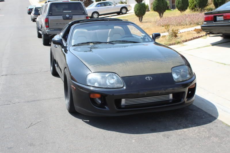

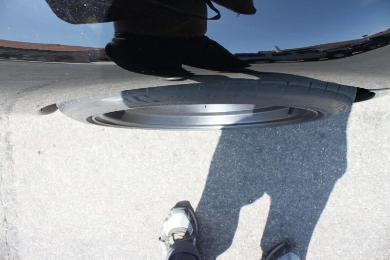

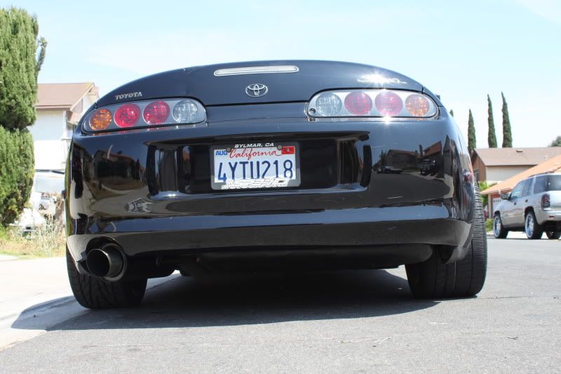

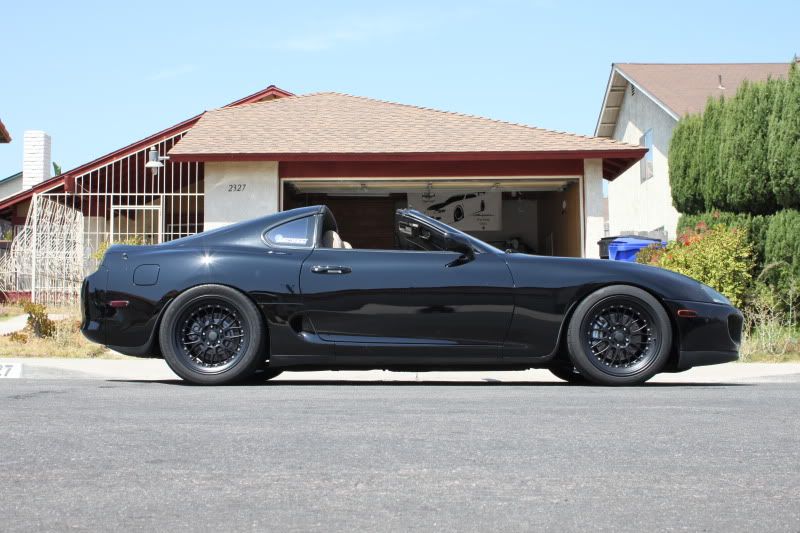

So ive been getting a lot of pm's about my rims on my Mkiii and people complimenting it. A lot have been asking about how it would look on a 4th gen supra, luckily, HolyCowMKIV lives 3 minutes away and we took the liberty of putting it on his car to help out the forums.
Specs
Rims: Sportmaxx XXR 521
Size: 18 x 10 (all around)
Offset: +25 (all around)
Tires: Rear, eagle F1 296-35-18
Front, Michelien Pilot Power Sport 275-35 18
Car: 93 Toyota Supra targa
Suspention: Tien Basic coilovers
HI-RES, UN-EDITED PICTURES:
this is how my supra looks
Hardtopper
13,043 Posts
So... they don't fit. Looks like you will have a hell of a time turning and there is no way you can run those rears on stock fenders.
Mr. 2JZUL8R
6,024 Posts
Too much tire. 265 in the rear, 245 up front. Fit.
Im A Fuking Ninja!!!
4,584 Posts
too "hella flush" for me lol... rims look good but they do not fit witht hose tires
Hardtop Crew
6,421 Posts
Looks sick but 10.s all around on a supra?? :(((( 8 front 10 rear with a 275 or lower imo :)
1,088 Posts
Definitely better on the MK3 hands down!!!
150 Posts
Did you guys drive the car on this setup at all? I heard that the fronts will foul on the sway bars? Were there any drive-ability issues at all (if in fact you guys did take them for a test run)?
150 Posts
I just ordered a set of 10inch 521's all round [+ 25mm], and am currently considering running 295's in the rear (like in the above picture, however ill probably settle for 285's and 255's up front). I plan on rolling the guards (and cutting if needed be). The car is on stock bilsteins at the moment. Again, only issue i want to have clarified is whether or not the wheels will foul on the sway bars when turning (if they do, i'm going to quickly change the order to 8.5/10inch setup.)
