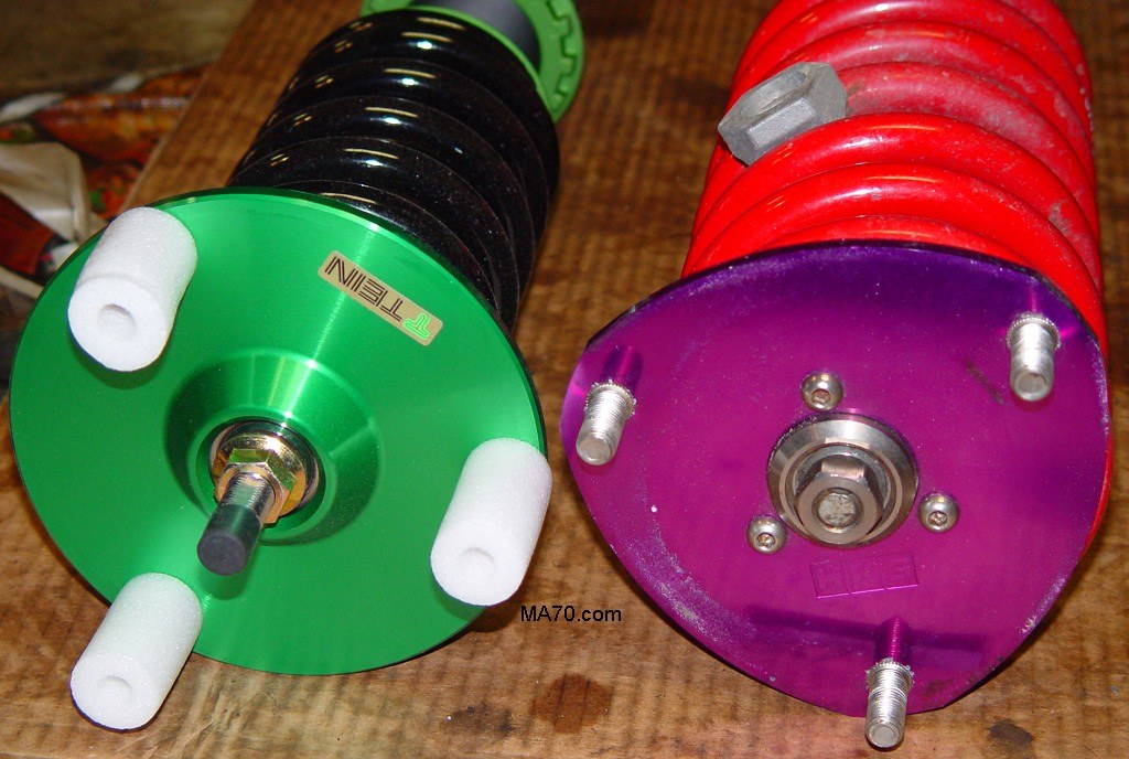

Well I had a hard time finding info on coilovers for the MK3 so I'd like to share my experience. First the pics:
Tein pillowball mounts vs HKS mounts
Tein Flex vs Tokico springs & HP struts
Tein front 671 lb rear 336 lb
Tokico front ~440 lb rear ~220 lb
Install went pretty smooth, because of the coilover design it's actually shorter then a spring/strut combo. Putting the coilovers in was easier then installing spring/strut combos. Setting them up however is definitely tricky. To properly setup coilovers you need access to corner scales. The measurements that Tein gives are adequate enough for most people, so I'll deal with that for now. You can adjust strut rebound/compression, car height and spring pre-load.
Driving impressions are damn nice. The car just sticks to the road. There is still some body lean on cornering, braking and acceleration but it is noticeably more stable. A little hard to describe, but after a few hundred miles I can safely say anyone who enjoys cornering will definitely want to look into coilovers instead of spring/strut combos. The strut rebound and compression rate is adjustable up top without the need for any tools. There are 16 adjustments per strut and it's pretty easy to feel the difference between full firm and full soft. On full firm the car is still not too rough, even with the targa off. On full soft it certainly doesn't ride like a luxury car, but it is soft enough to give a smooth ride. In the few hundred miles I've driven since the install I haven't scraped once. With my old setup I would scrape on some of the crappy New Orleans roads I had to drive on. Tire cut through the plastic cover and straight through the airbag sensor wire (pic attached). For a while the tire was rubbing on a couple screws and was getting nicely cut up. I had to cut the screws shorter to stop that. Anyway, that is no longer a problem anymore.
So there you go. Coilovers = awesome. I wouldn't recommend the Tein Flex to a race-only car, but for a street car they work perfect.

adjuster: $1300 There is actually less clearance for a larger wheel now, tire is unaffected. The strut body on coilovers is made larger to increase reliability and pressure. If you went really low with the rear you could fit larger rim/tires. My MK4 rims with 255's clear just fine, and 275's will fit as well. However I do not think a 9.5 or wider rim with a 35mm or less offset will fit. MK4 rims fit fine, any rim with similar specs will also fit fine.
twinturbozs: I definitely feel the bumps more, but they don't break my teeth when I hit them. It's just a generally better feel for the road.
flubyux2: Flex is a whole new line. Supposed to be a more streetable coilover with the same replaceable and rebuildable aspects. Also it has a spring pre-load which is separate from the ride height adjustment, that's a feature I haven't seen in any other coilover.

josbeat: that was probably on the old model Tein's. The new ones such as the Flex come properly assembled from the factory. Also I've already got ST sway bars, strut bars, rear cross brace and lower arm bar. All I needed was coilovers and now they are done.
There's no way to make a Supra handle like an exotic sports car, it's an old car without the huge budget that exotics have. However you can make it handle decent enough to have some real fun with it. I have the Yokohoama AVS ES100 on my car and those tires hook very well. Stock MK4 size - 235/45/17 F 255/40/17 R, my next set will have 275 or 285 rear's.
EDFC to me serves no real purpose. You can adjust the struts with no tools at all, or pay $300 to do it from the cockpit. I'm simply not that lazy nor do I like gadgets that much. The adjustments between full firm and full soft just aren't drastic enough for me to be switching them all the time. I'll be running full soft on road trips, full firm the rest of the time.

One little note: if you haven't got sways already, get them when purchasing these. After having them on a year now, I've noticed that they will still let the tire rub the plastic inner fender when doing hard slalom, or on setting into a hard corner with any dips in the pavement at the Tein recommended measurements. The contact is very light, and sways should provide enough additional roll control to eliminate that nasty downside. Otherwise, Tein allows you to purchase slightly stiffer springs on ordering. Their customer service department recommended to me that +2k front and rear would reduce or eliminate this problem, and still is within the range of control that the dampers can deal with. They suggest that the MA70 may be slightly more nose heavy than the JZA-70 these were designed for.

2 kg/mm higher spring rate than the set normally ships with.
I too noticed that they were not set up exactly from the factory and needed a few adjustments. My installer (also my Tein dealer) pulled upt a vernier caliper and set them to exactly Tein's recommendations. They race on Teins for their cars and suggested that they are rarely perfectly measured from the factory, though they are close. It was suggested that they know/expect that the cars are going to need corner weighting after installation, and so a little off is just going to be adjusted out by the owners anyhow. They did install all the parts correctly though.
