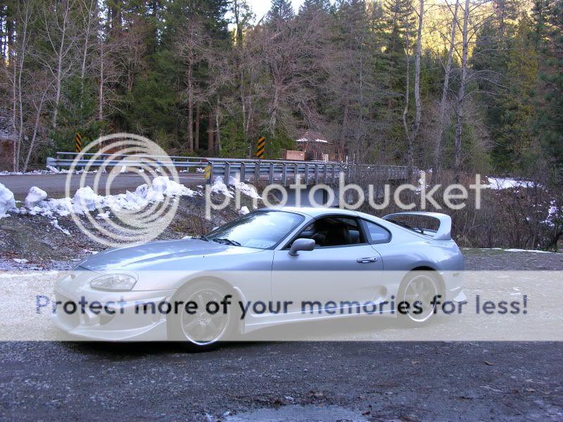

This is an old shot, but if i don't squat down and eyeball my setup, I really can't tell the difference. Even then, I'm not sure that I'm not just "seeing" the difference cuz I know that it's been "changed". If anything I think I detect a better forward cant. However slight, it seems more 'muscle' or 'drag' stance (angled nose down), than 'flat' which is how I would describe the setup before. I'll try to get pics soon. Had to drive work yesterday, and drive today while it's dry enough...Been storming up here. Thursday should be clear, and if there's a gap in the rain tomorrow I'll get something up. The problem is finding an old pic that was taken from 'level' or low angle, and then getting a new one with the car in the same spot, and at the same angle.
On the ride height: Trust me, it looks nothing like BruceWayne's '4wheeler' pics! It's more like stock. I can put two fingers in w/ a little room to spare, but definitely cannot fit three. I'm sure this setup with the helpers could be lowered, but I live in the mountains and daily drive mine, so I need it practical, not scraper (which I do actually like). Remember, though, Drew did not spec this setup out for slamming. There isn't a whole lot of travel to work with.

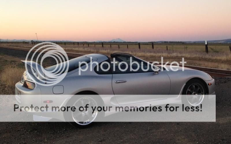

"BEFORE" PICS for reference wheels are 18"
These are from April, & Sept/October of this year, respectively.

So These were three days after install. I still have not gotten any shots similar to or same as the ones above. You can see, however, that same stock looking ride height i is there. I would love to slam it, but I need the clearance and shock travel.
