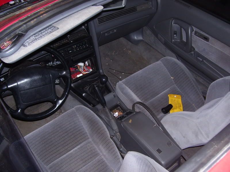

oh heres some pics btw.
This one below was taken at the previous owners house.
