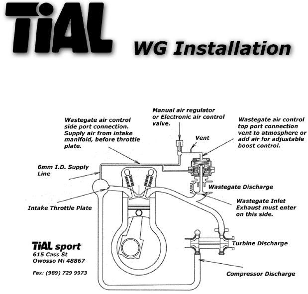

I went to the Tial website and looked at the instuctions but i want to make sure with the forum that it is correct. Or if somone can just please do a quick step by step write up. (single turbo)
So if anyone can help me out, i would appreciate it very much! :)

T the compressor fitting with the in port on your boost controller to the side port. The top port goes to the out on the boost controller. Make sure if its a electronic boost controller to have it set for external wastegate.
